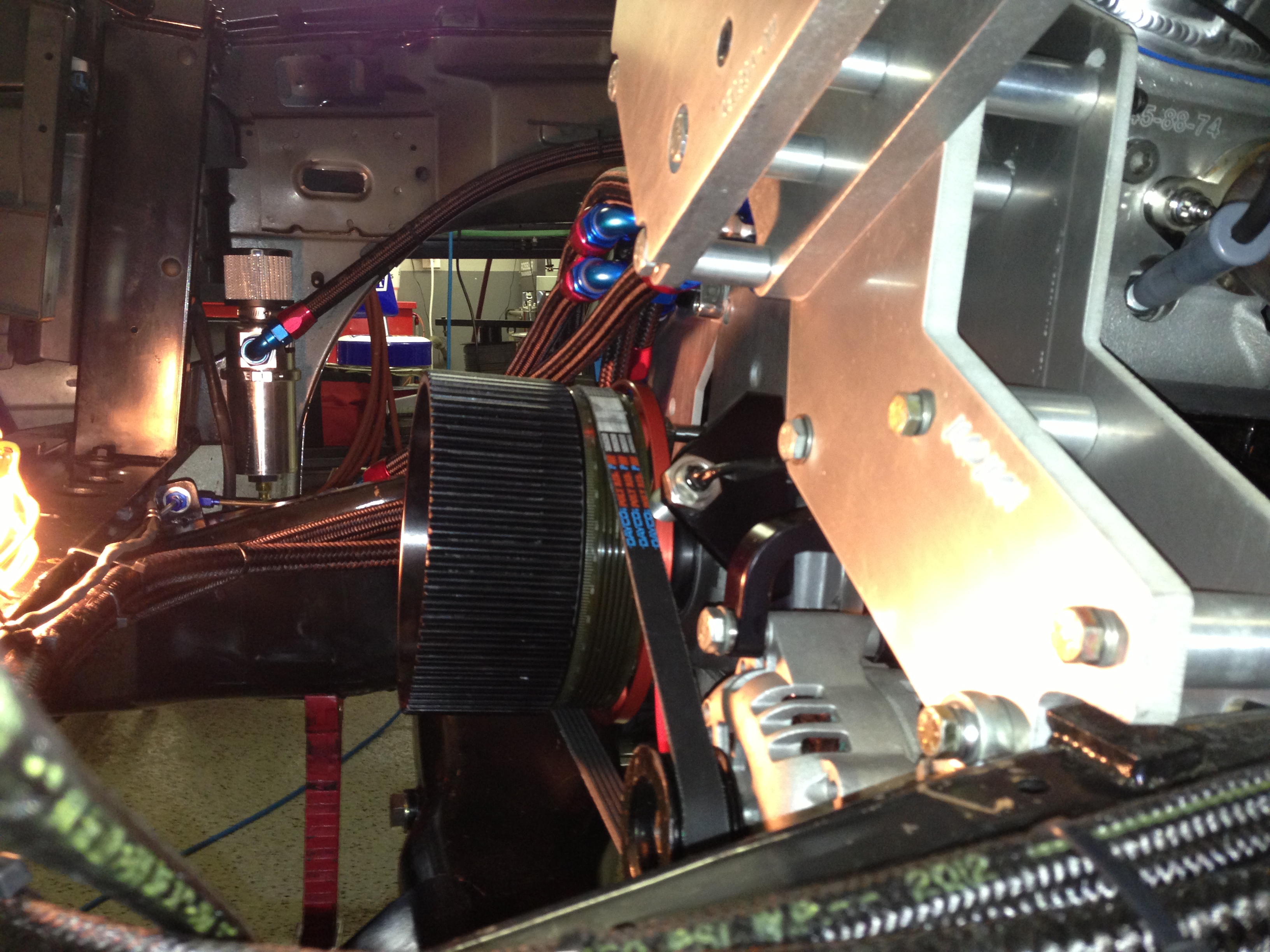

Catch cans......check.
One for each side feed by -12 lines coming off each valve cover. Can't find a pic of the one on the driver side.
