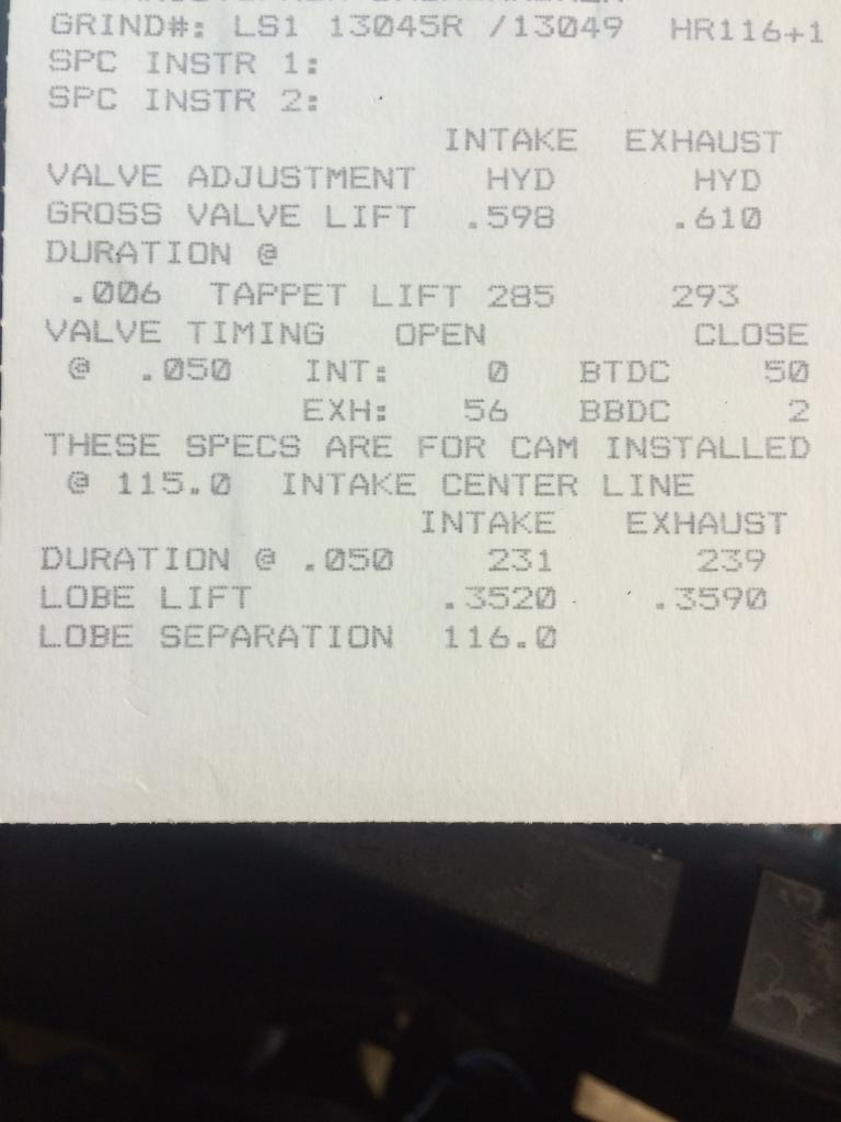

So, I just wanted to get a few opinions on this cam that is in a 408 with WCCH LSA heads and Hi-Ram intake. I am also running a BW S485 turbo with meth. The converter I got from FTI is a 3600 stall and the truck has 4.10 gears. I may send the converter back off to get re-stalled if I dont like how it works. I am tired of throwing money at the truck and I am trying to get away with this cam, but not too sure how well it will work. What do you think about the cam?

Sure looks good.. Lol
