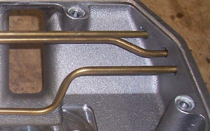

Yea we have done stuff like that. The problem you will run into is if a plate is built the thenest it can be is 3/8" + add a gasket so your injector hold downs move, blower get raised etc. Alot easier I think to install into the tub it self... shown in one of the pics.
later
Attached Thumbnails NOS and Radix-100_1799.jpg   NOS and Radix-lightnig-spray-bars2_sm.jpg

Another thing we can do is build a custom bad *** plate for behind the Tbody. machined with stock oring etc. Just let us know how we can help you meet your HP goals and we'll work with you to make it happen.

The advantage of the spacer was that not a lot of people were comfortable spraying nitrous through the rotors, and it placed the spray after the rotors. I like the idea of installing them directly into the case though....you may have a market for something like that I was planning on putting spray on my Radix before I sold it.
