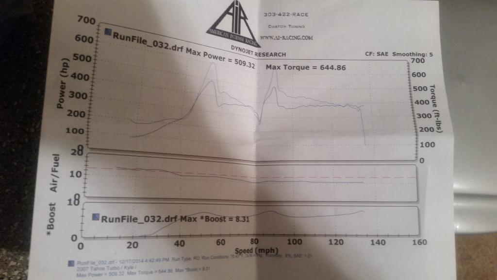

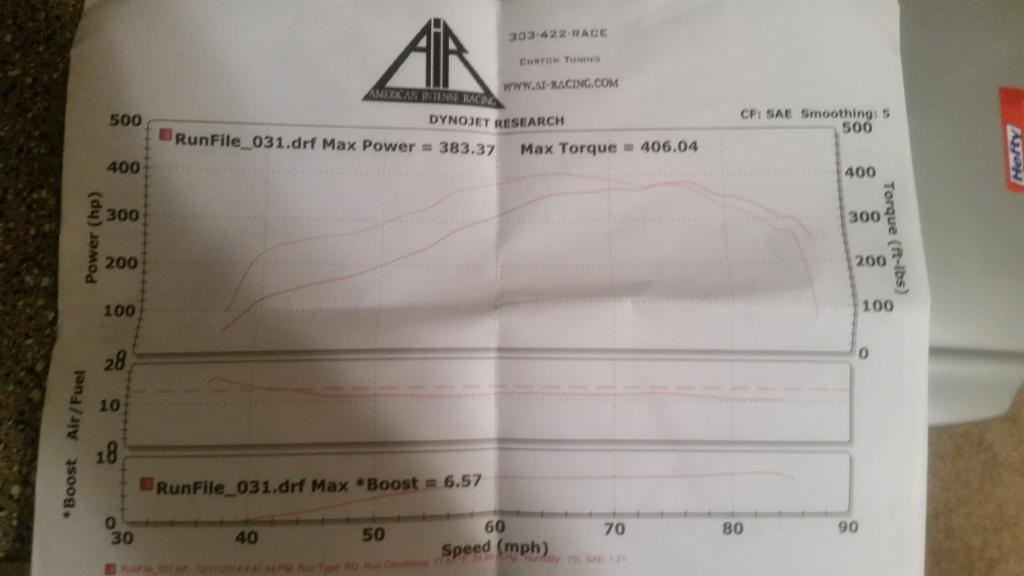

Was getting false knock because when the motor torqued
the manifold hit the frame.
Imma have to pull it off and hammer or cut out a part on top of the shock tower
So left it on 6.5 psi bc wasn't sure if it was real knock.
383hp 406t
Was having boost spikes and saw 12 lbs 600 hp

Nice numbers for 6.5 psi.

So you gained almost 240Ft lbs of torque with almost 2lbs more boost?
Old Dec 19, 2014 | 12:59 PM
black00chev's Avatar
Slowest turbo build ever!
Joined: Dec 2009
Posts: 2,905
From: Warrenton, VA
Dont look at the peak numbers, they must have ran the truck through a couple gears. Those spikes are the shift points IIRC.
By the looks of it I think 50ft/lb was picked up.

Those are just shift spikes.
