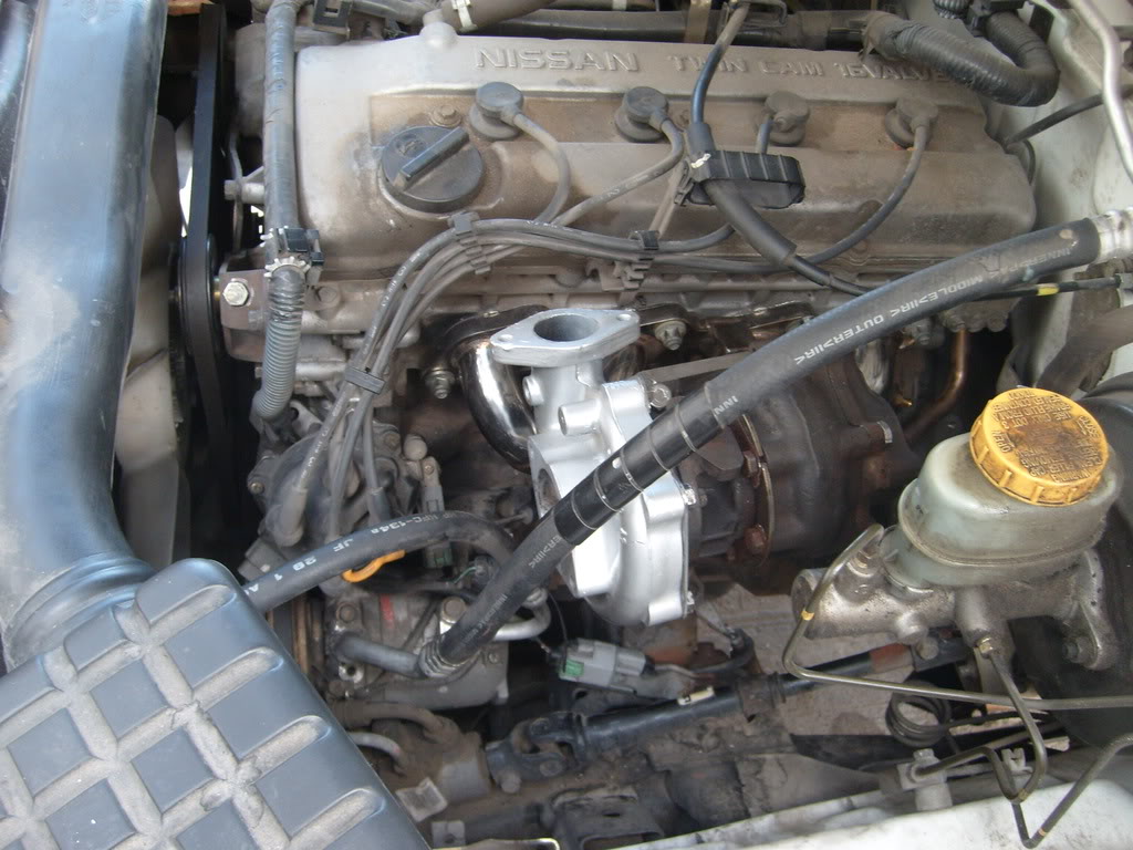

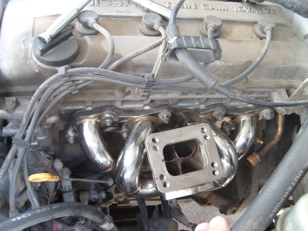

This is my Dads little 2.4L 4 banger truck we have been planning on a little turbo for a while now. Our goal is to just make 40-50 more hp. maybe 3-5 psi of boost. Not trying to make huge power just alittle more ummphh for towing a 1100 lb pop up camper. Probably won't change anything as far as tuning or fueling goes unless its absolutely needed. The manifold we bought a couple years ago off ebay for 200 bucks, its stainless and is actually intended for a 240 which shares the same block as these trucks. Turbo I believe is a T2/T3 from an old 4 cyl turbo mustang, which was donated. I think this will be the easiest and cheapest turbobuild ever, lol

WJ MARK Aug 7, 2008 05:12 PM
soory for the larger pics! and I know its dirty, lol

Probably a week or so. Need to machine some flanges for the DP Etc..... Really not a whole lot to it.

You're right it is slower than crap, LOL. 143 hp. stock at the crank im sure. I think we can get 180 at the wheels wth really low boost. Its starting to come along, DP is almost done. Need to make a carb hat and a few more flanges for the cold side of the turbo. Other than that just waiting on some parts to show up.
