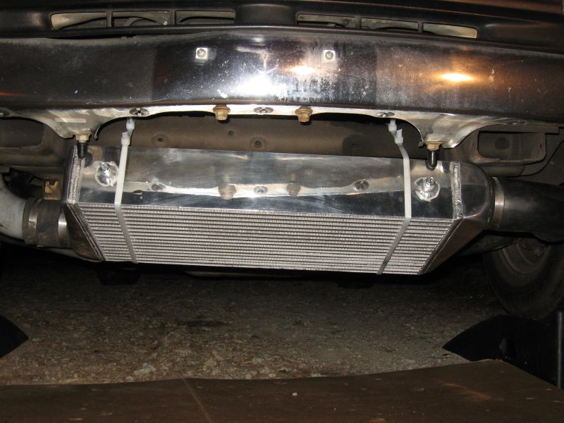

got the smaller ProCharger FMIC off...
got the pipes, coupler and 90* cleaned off...
got the coupler cut down a bit...
got the coupler and 90* on the new FMIC...
going back outside to fight mosquitoes (WTF...already?) and see if I can slide this biotch in place with a lil' lubrication and a lil' persuasion...
BRB...
it's not gonna direct fit...that's for sure...
90* is almost folded in half...
enuf for tonight...skeeters are tearing my *** up...
maybe I can swap one elbow pipe from one side to another
and that may shift things around enuf to work...
supposed to rain all day tomorrow...
let me go read through 'Black Blown 02's thread again...

I just went back to the pt.net thread where 'Black Blown 02' did a similar FMIC...I see what he did now...I think I can make it work with the same stuff I have by flipping the IC around where the driver side will connect with the coupler near the frame and the pass side will use the 90* near the bumper...it won't sit dead center, but neither did his...

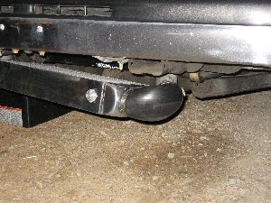

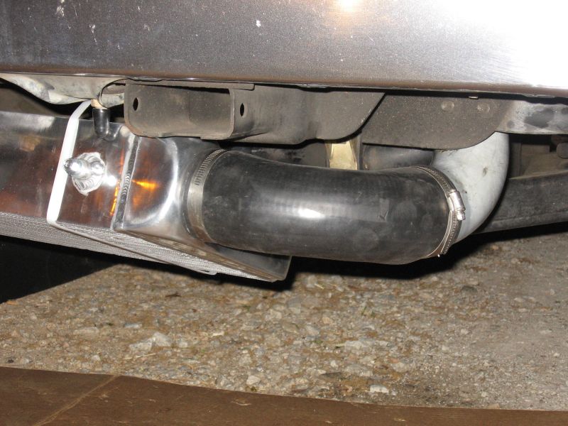

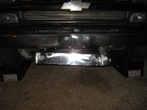

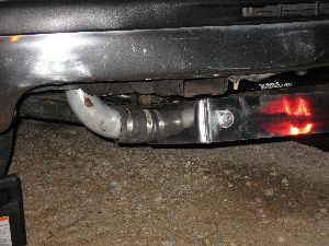

that plan didn't work...
new fmic is too long to work that way...
many thanks to cablebandit for stopping by the house, taking a look at the setup and helping out with an extra brain...2 extra eyes and 2 extra hands...
we re-routed the ProCharger pipe and elbow coming from the purge valve down to the fmic...routing it to the other side of the frame towards driver side...
seems to work with existing stuff now... I linked two HVAC ty-wraps together and cinched the fmic into place on left and rightn then tightened all the 90* and coupler clamps...got 4 metal braces cut and bent to my liking for further support...just need to install them using the threaded mounts on the fmic and a few frame and bumper bolts, then remove the ty-wraps...gonna try to lower the pass. side end a bit to level it...battery was dead on my drill, so i couldn't drill holes in the braces...slid a couple vacuum caps over the two bumper bolts right in the front...truck is driveable now...I'll finish the braces tomorrow or Saturday morning...I hope I don't blow a coupler or a 90* off in the morning when I put my foot in it on the way to work

so far...so good...
been riding with my Predator plugged in to monitor the IAT...about 10 degrees above ambient is about as high as I have seen it go...that's from romping on it a few times this morning in 49* weather and this afternoon in 65* weather...haven't stayed in it through a 1/4 mile yet...
