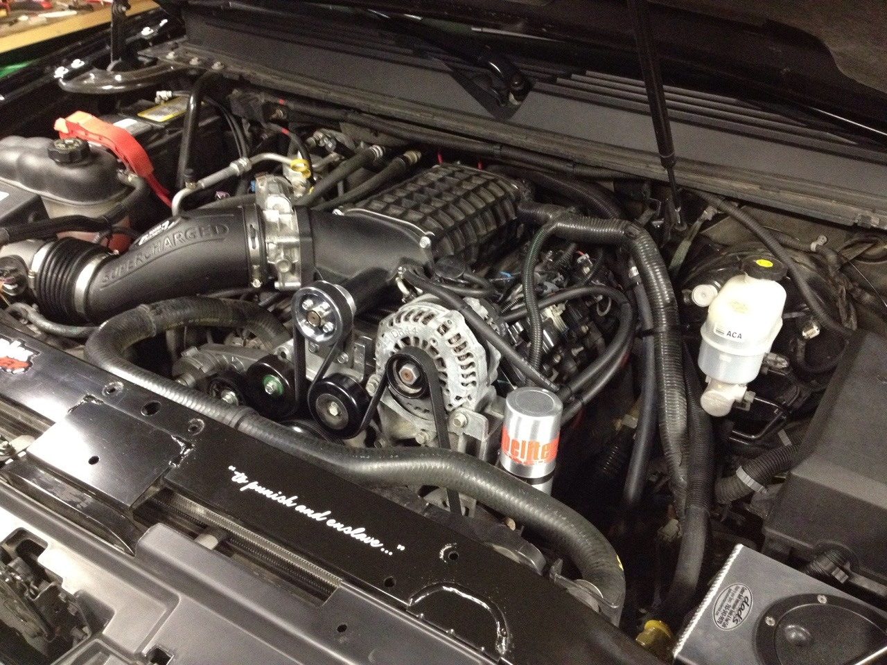

That will rip pretty good...wish i had the LTs and gears....
I have a larger Dads custom tank for mine...looks pretty good...not sure if its needed but i didnt like the stock plastic tiny one...u can kinda see the whole tank here on the corner...

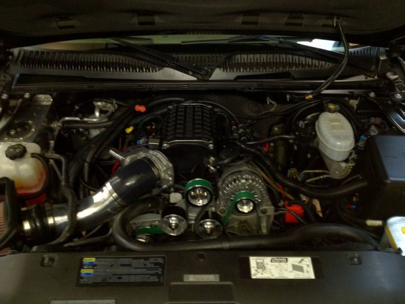

Recent picture of mine.

03sierra. Talk to me about ur tensioner and pullies. I think I'm getting belt slip. Every time I let go of the throttle at higher rpms I hear squeaking

Yes please give us details on the pulley setup, looks like an 8 rib? Is that the LS9 belt ?

It's a 8 rib setup with a 10% overdriven crank pulley. Pullies are from joe@leftcoast32 (site sponsor) and the belt is just a gates HD green belt.
