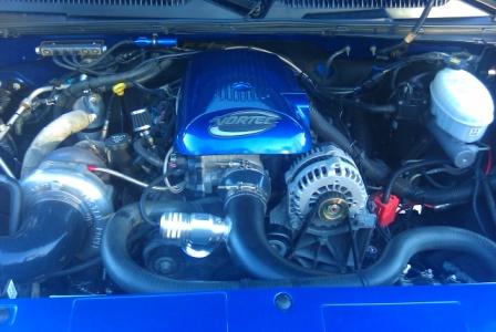

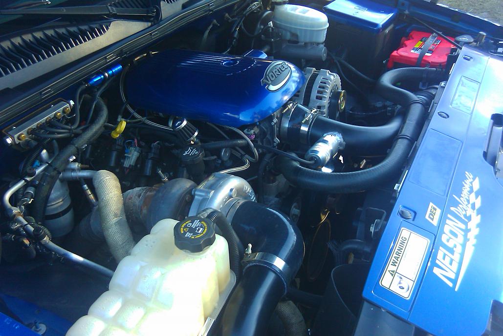

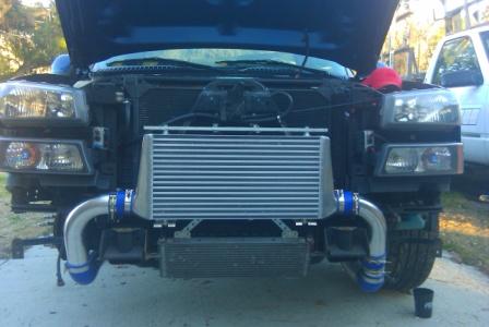

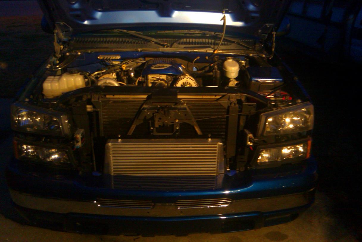

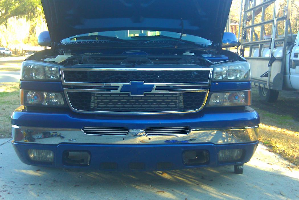

here is a few pics of my kb kit, I did the intercooler my self though. If your truck is low your not gonna like it down low, I had to learn that the hard way. I put my return line in the passenger side of the pan.

how are ur guys water pump lines???mine are a lil too close to the turbos hot side
Old Sep 4, 2010 | 12:47 PM
JoeyGC5's Avatar
iTrader: (24)
Joined: Jun 2003
Posts: 2,674
From: St Joe, MO
Use the extra hose and barbs to splice the hoses and route them out of the way. The hoses in my truck at closest to the compressor side are like 3 inches away. I used the stock hose bracket and modified it to bolt to the upper/inner front of the pass side head also.
