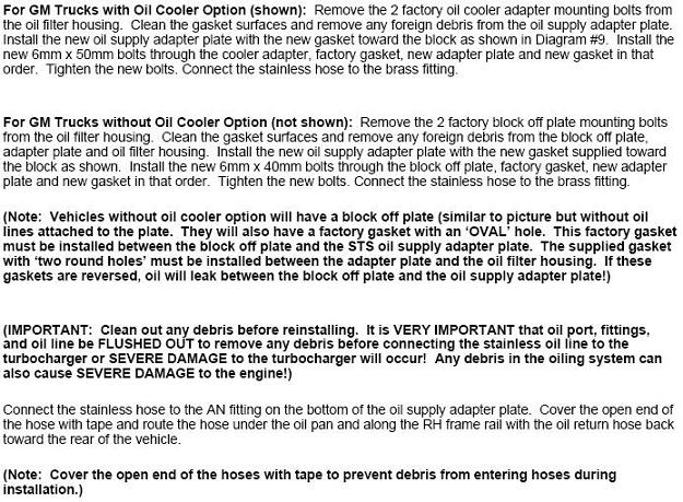

Originally Posted by turbomax
i ordered a plate from sts there's gos between the oil cooler lines
Here is what the STS comes with.
Attached Thumbnails need to get oil to turbo...-oilpump3.jpg   need to get oil to turbo...-oilpump4.jpg

The older STS instructions had you drill and tap the OEM block in the bottom, 15/16" from the rear of the block, near the plug in the one in the picture above. Drill a 21/64" hole and tap to 1/8" NPT. Coat the bit in grease to hold the shavings. Start the engine for a couple of seconds to flush out any shavings. You can do it without the STS adapter but it is a hard place to work in if you are 4X4 like the one in the picture. I unbolted mine enough to flush it out with paint thinner (or varsol). The job gave me fits but I got it done and it has been fine for almost 4 years.
