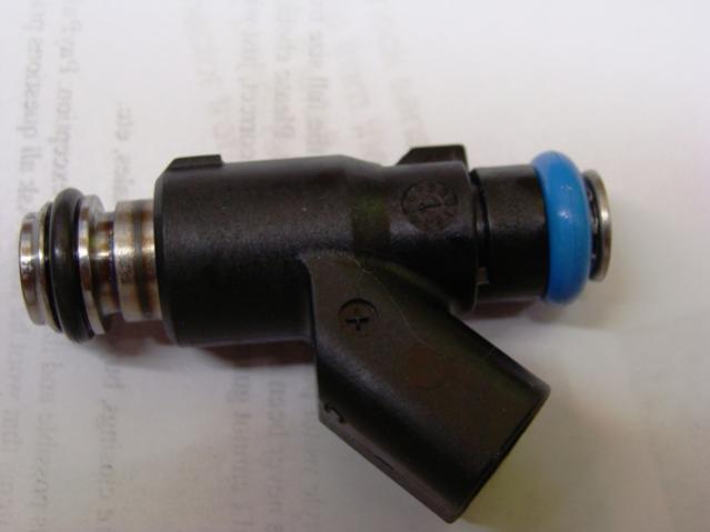

Originally Posted by skipperdaddy
Good luck, a few other guys, my tuner included are having a hard time finding data on these injectors, so if u come across something please post it up!
Yes, whats the deal with these injectors? I cant believe we can't come up with anything.
BTW, Justin @ blackbear seems to think these injectors might be more than 42 lbs. My computer is with him now getting adjusted. I've been getting the check engine light; codes: PO172 and 175 rich right and left bank fuel trim.

Are there any sort of numbers stamped on the injectors?

Yea, im at work now but i gave the numbers to my tuner and he hasnt found anything yet...

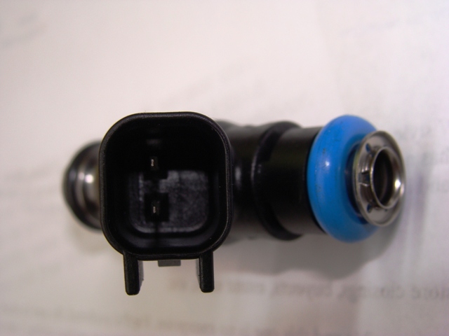

Here's the mystery injector
Attached Thumbnails My turn to get Blown R TVS1900-feb-2010-129.jpg   My turn to get Blown R TVS1900-feb-2010-130.jpg   My turn to get Blown R TVS1900-feb-2010-131.jpg
Old Apr 29, 2010 | 09:11 AM
  #97
o2man98's Avatar
Joined: Oct 2004
Posts: 230
From: Wisconsin
They appear to be the Delphi Multec 3.5 E85 injectors.

I do not know the specs on this one but it looks very similar if not the same.
http://www.amazon.com/gp/product/com...au_pf_dp_chart
Fits newer Hyundai models like the 3.8L Genesis. These flow 31.135 at 380 kPa so not what we are looking for.
I looked through all the info I had on Delphi FJ injectors and failed to find any that looked similar and flowed 42 or higher.
Here is some Delphi specs. http://go.delphi.com/CS/documents/DP...lish_11073.pdf
Multec 3.5 https://delphi.com/shared/pdf/ppd/pw...ultec_mpfi.pdf
