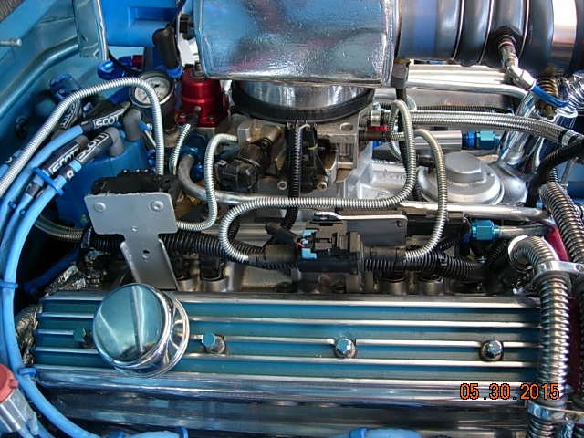

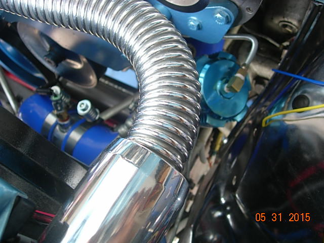

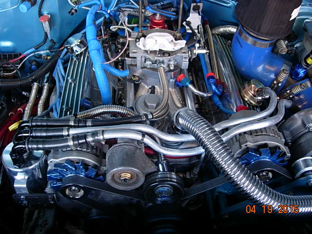

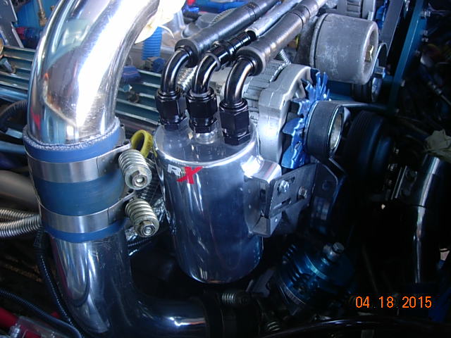

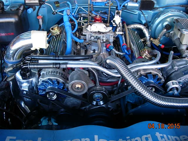

after finding a lot of oil in my intercooler piping I decided to in this....
1st I had to find a location

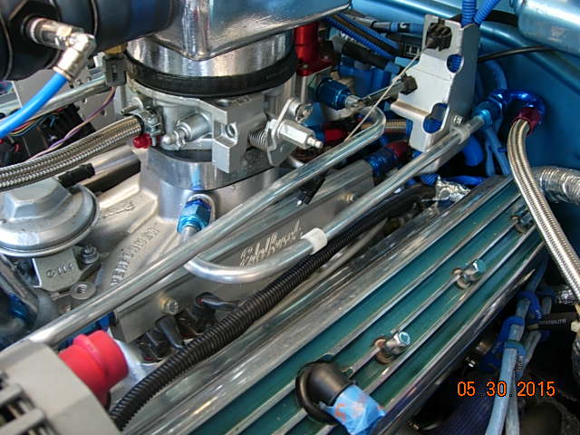

pre fit the piping...I don't like a lot of rubber hose, so I made my own from -8 and -10 aluminum pipeName:  DSCN0068.jpg
one went to the throttle body (has valve in line)
one to the valve cover
one to the inlet of the blower (has valve in line)

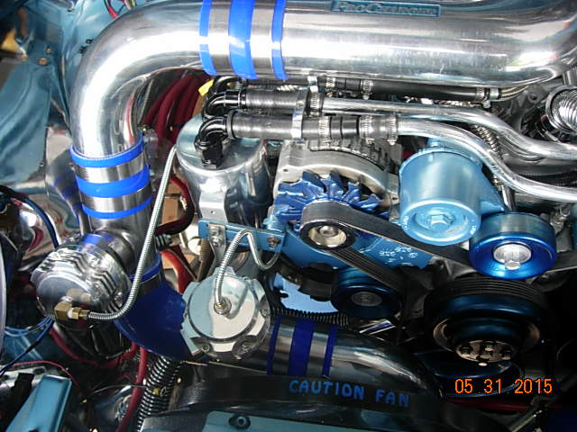

finish the lines and clamped them upName:  DSCN0071.jpg
and gave the aluminum a little polish

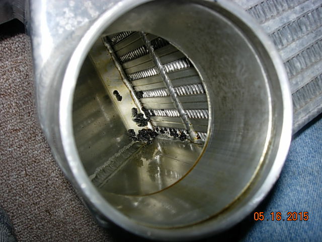

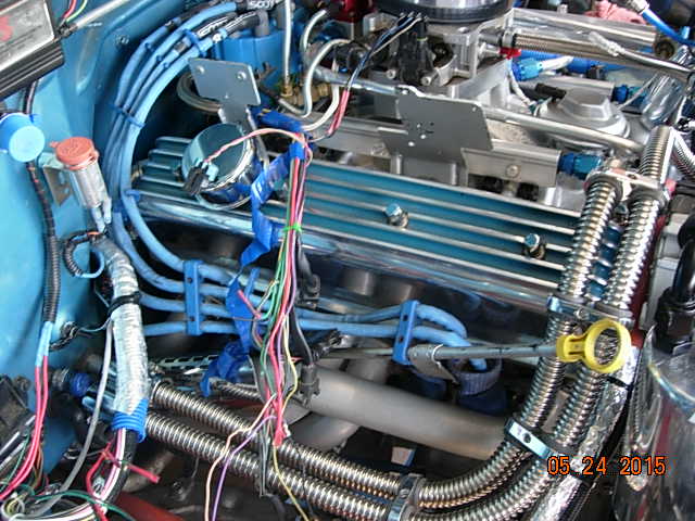

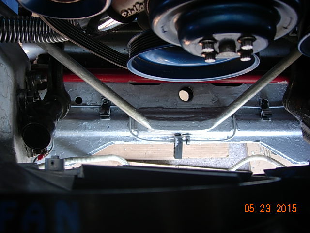

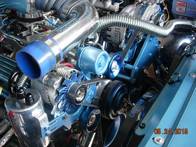

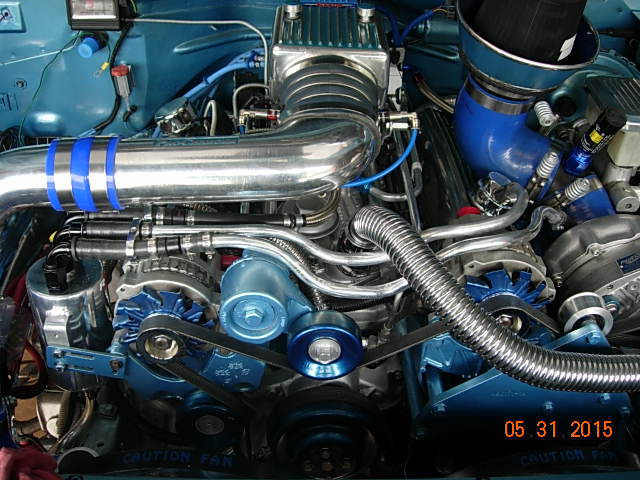

so after finding this crap in my intercooler I took everything apart
I cleaned my frame up
added new heater hosesName:  DSCN0140.jpg

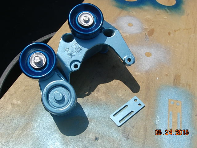

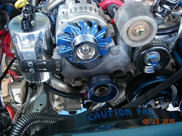

decided to paint the new alternator bracket
Size:  96.8 KBName:  DSCN0147.jpg
clean up wiring and add dual IAT sensorsName:  DSCN0146.jpg
Size:  93.9 KBName:  DSCN0162.jpg
started putting stuff back togetherName:  DSCN0179.jpg
plumb the new BOV's
and some how I was short 4 clamps, so more to come....

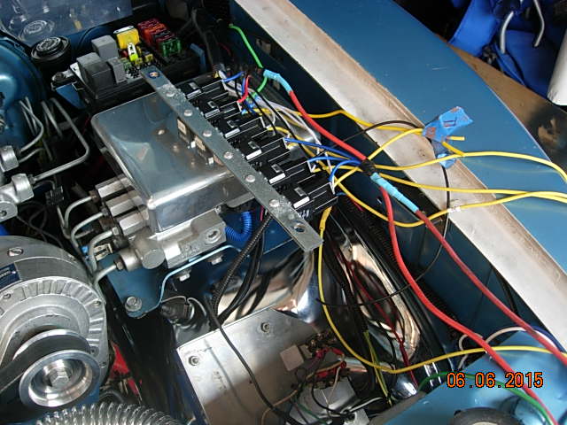

Joined: Jun 2012
Posts: 89
got the clamps done on the intercooler piping as well as mounting 2 fans on the intercooler
wired them in as well as some driving lites
