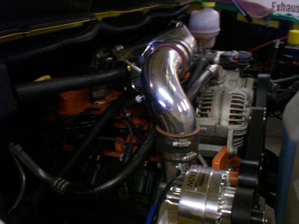

Okay...This setup is with a Paxton centrifical blower and a Vortech intercooler. The intercooler is mounted in front of my throttle body. I then have a 12" piece of piping, with one 90 degree bend in it, where my SnowPerformance w/m injectors are mounted, which then attach to the output side of my blower. What my question is, is should I inject my w/m through the water/air intercooler, or after it behind the throttle body?

Here is a pic of his set up.

Have you talked to GSM to see if they've done any tests of spraying a wet mix through the i/c?
My thought would be to run it like you have it (through the i/c). With the smt6/injector setup you can pulse your fuel to a lower a/f. It's amazing what an 11.2 a/f will do with cooling characterstics. Make some short burst runs to get EGT baselines. Then introduce your meth injection and see what your EGT's do. You may have to back off the fuel a little when you do this. After you make some runs, pull the i/c and look for puddling. If your EGT's stay in a comfortable zone and you're not puddling the i/c run it for a while and recheck.
