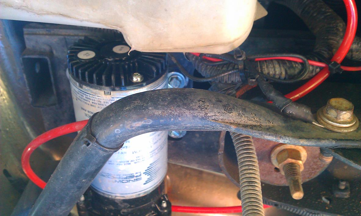

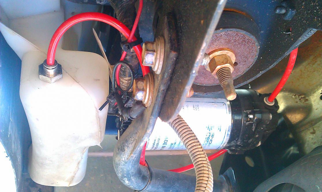

Here you go bro...
Attached Thumbnails Meth pump location-imag0568.jpg   Meth pump location-imag0569.jpg

Sounds like mine is mounted where Schino's is.

Sorry for the mess, doing some winter upgrades. I took out the support on the passenger side at the firewall. I bent a piece of metal for the controller, and mounted it there. I put my pump under it. I also ran an overflow tank to hold my water/meth. I have a custom operating system tune, and was going to wire the low coolant switch into the valet mode so when it got low it would not rev over 3k. I just haven't gotten around to wiring it up yet. Lol (I have always said, there are two types of people in this world, those who get things done today, and those... Ahh never mind I will just tell you the rest of it tomorrow)

Thats a pretty good spot, but with my turbo it would be right next to the downpipe, and since meth boils at about 150 I forsee lots of problems.

I bought a diesel battery tray and moved the battery to the passenger side. I then mounted the methanol tank in the battery's previous location and using and extension bracket I hung the pump in front of the pcm to clear my intercooler piping and auxillary fan relays.
