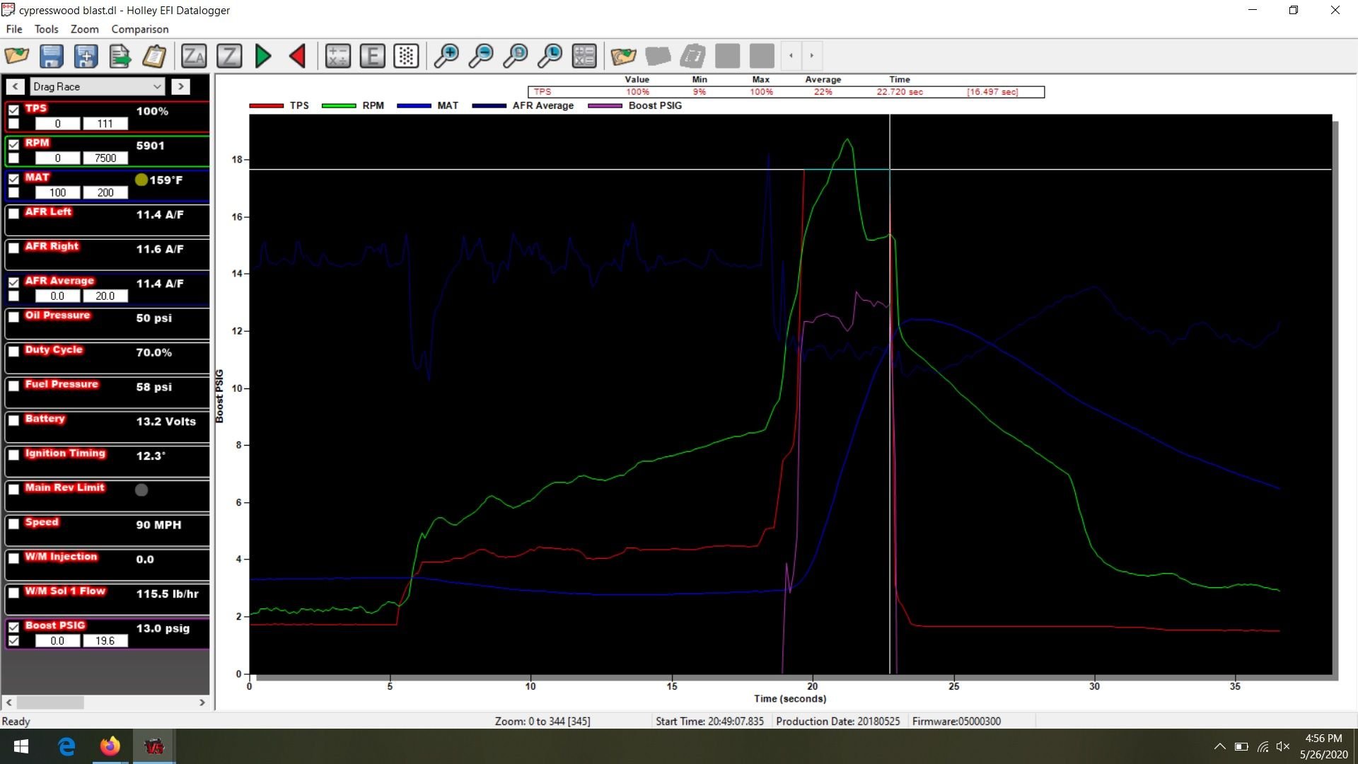

for those saying to run 100% meth, would you still do that knowing my motor is 10.4 compression at 12lbs boost with only .019 ring gap? part of wanting water to cool the combustion chamber is added insurance to my high compression with tight ring gap. boost was an after thought to this motor. and this blower runs HOT! I'll post a screen shot of a quick blast and how quick the temps shot up.

here is a 3.042 WOT blast without meth. Notice my MAT temps jump 42* in only 3 seconds. it continued to climb to 163 before recovering.

How much cooling capacity do you have. When I had the Whipple it climbed fast.
I added a 2.5 gallon coolant tank for it and it climbed but a lot slower.

I can run up to 8 gallons, but typically keep around 4 gallons in the system. -12 AN lines feed and return with a frozen boost type 101 exchanger.
I'm not as concerned about the rise in temp during normal driving, just under WOT.
