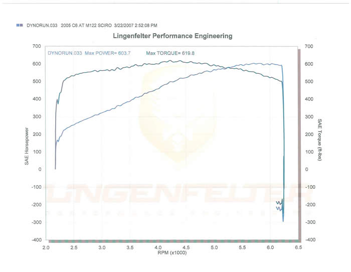

LINGENFELTER 122 results:
it's a 427 making 12lbs of boost at peak power
Old Mar 23, 2007 | 09:09 PM
  #137
1SlowHoe's Avatar
Destroyer of Transmissions
iTrader: (28)
Joined: Feb 2005
Posts: 4,962
From: Orlando, FL
Thats pretty nice! Looks as if full TQ was on by 2500rpm.
Any idea about IAT's?
What size pulley?
Makes me think a forged 6L/370 could see 15psi pretty easy.

Nobody recorded the dyno run???

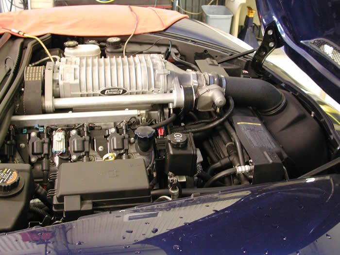

Is that a cog drive on the jack shaft? NICE!
