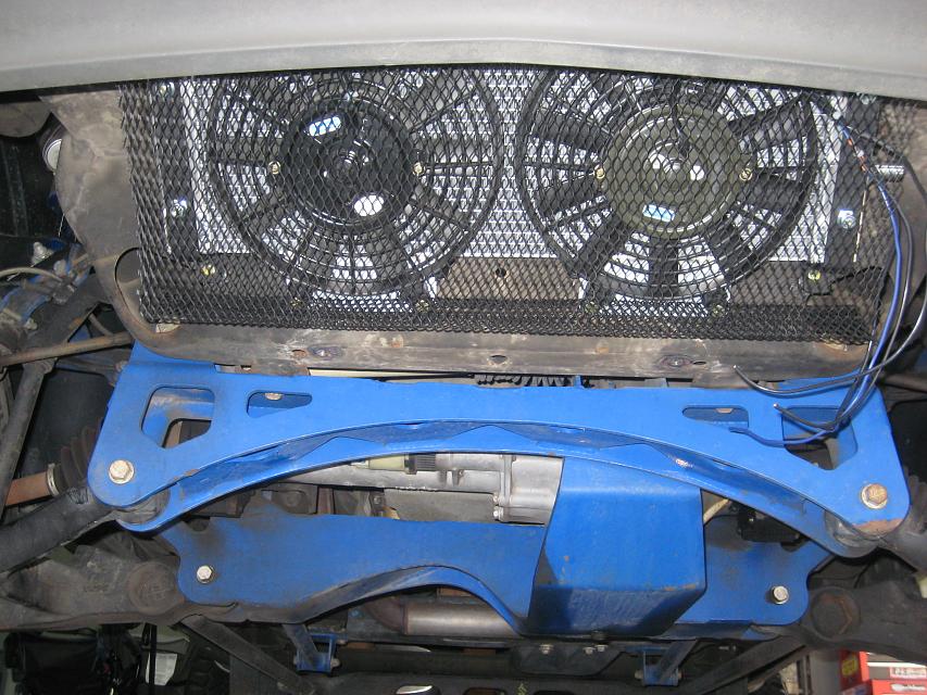

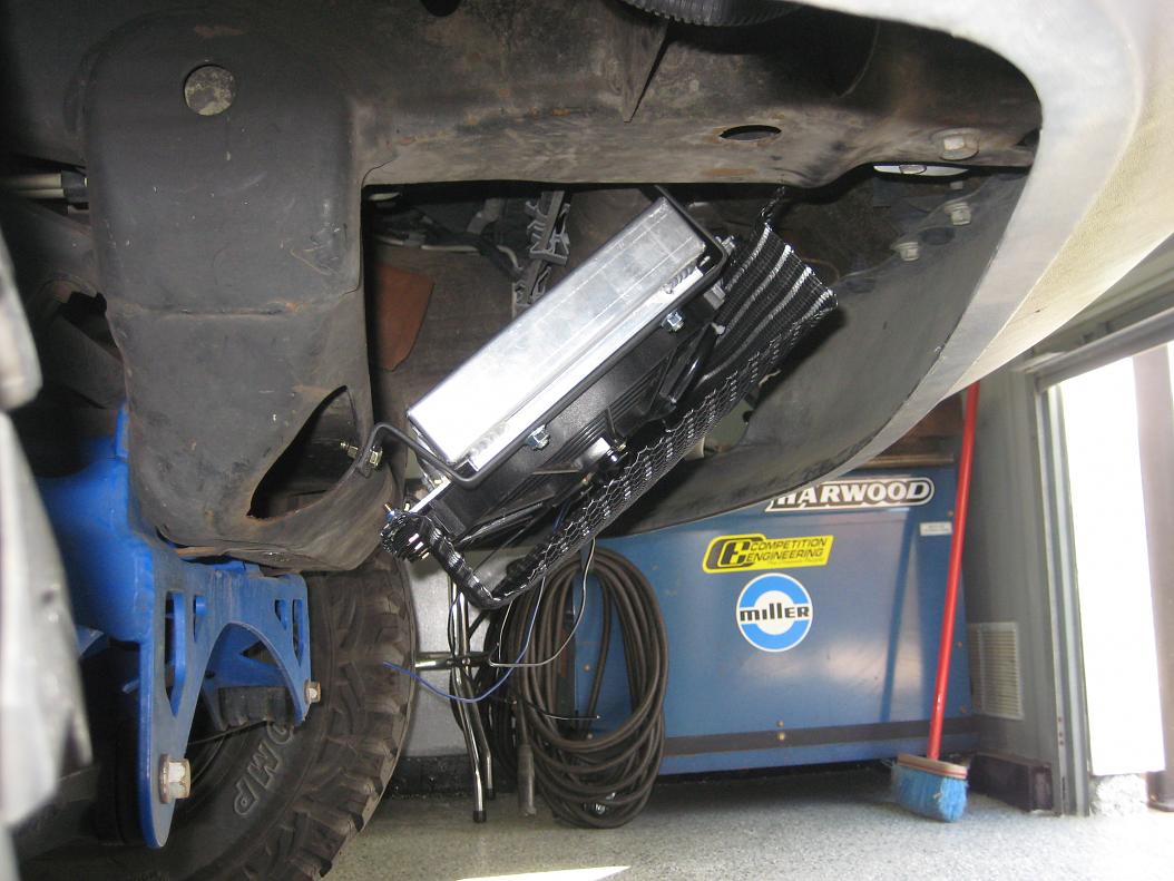

Finally got started on my Rdaix project, moving a little slow when watching my 3 yr old hehe. Anyways installed the tranny cooler and blower intercooler in the truck yesterday. Will be doing wiring today and then start on the removing of original parts soon. Have pics of the work so far.

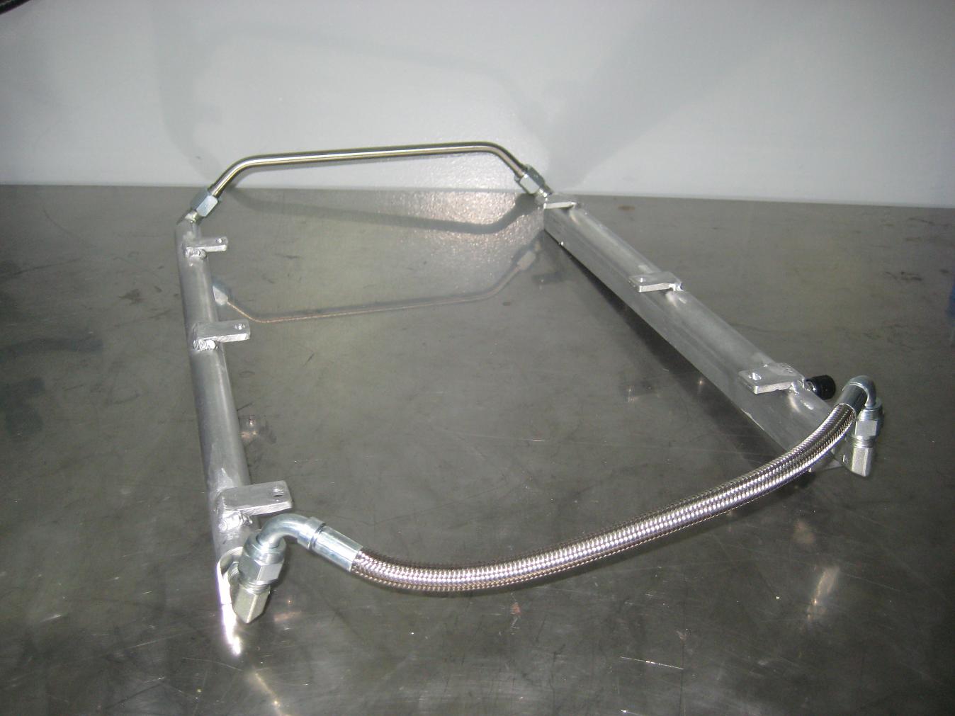

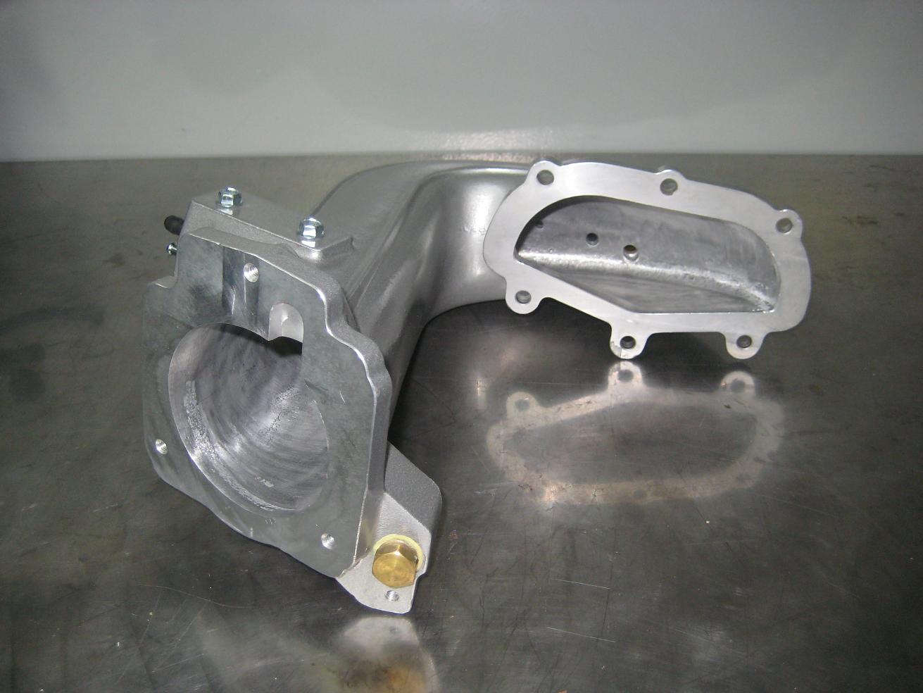

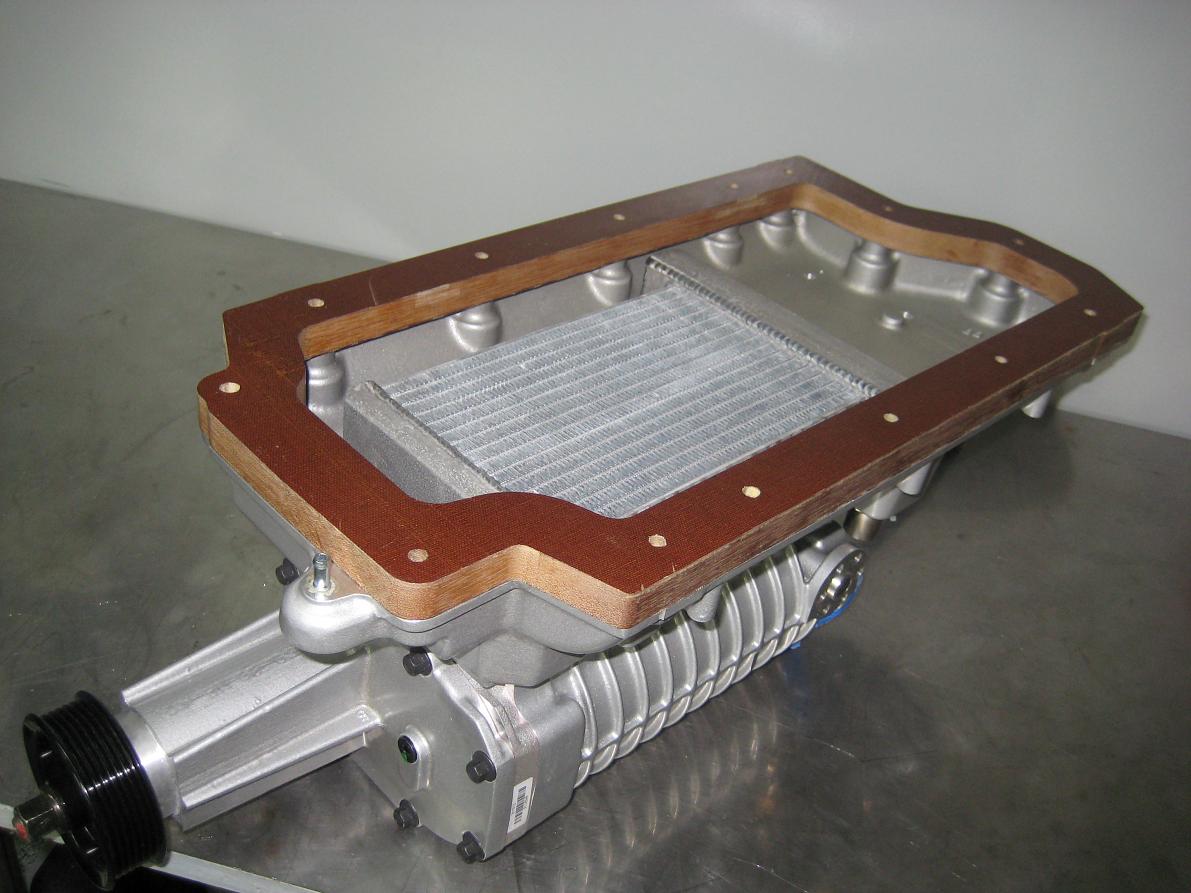

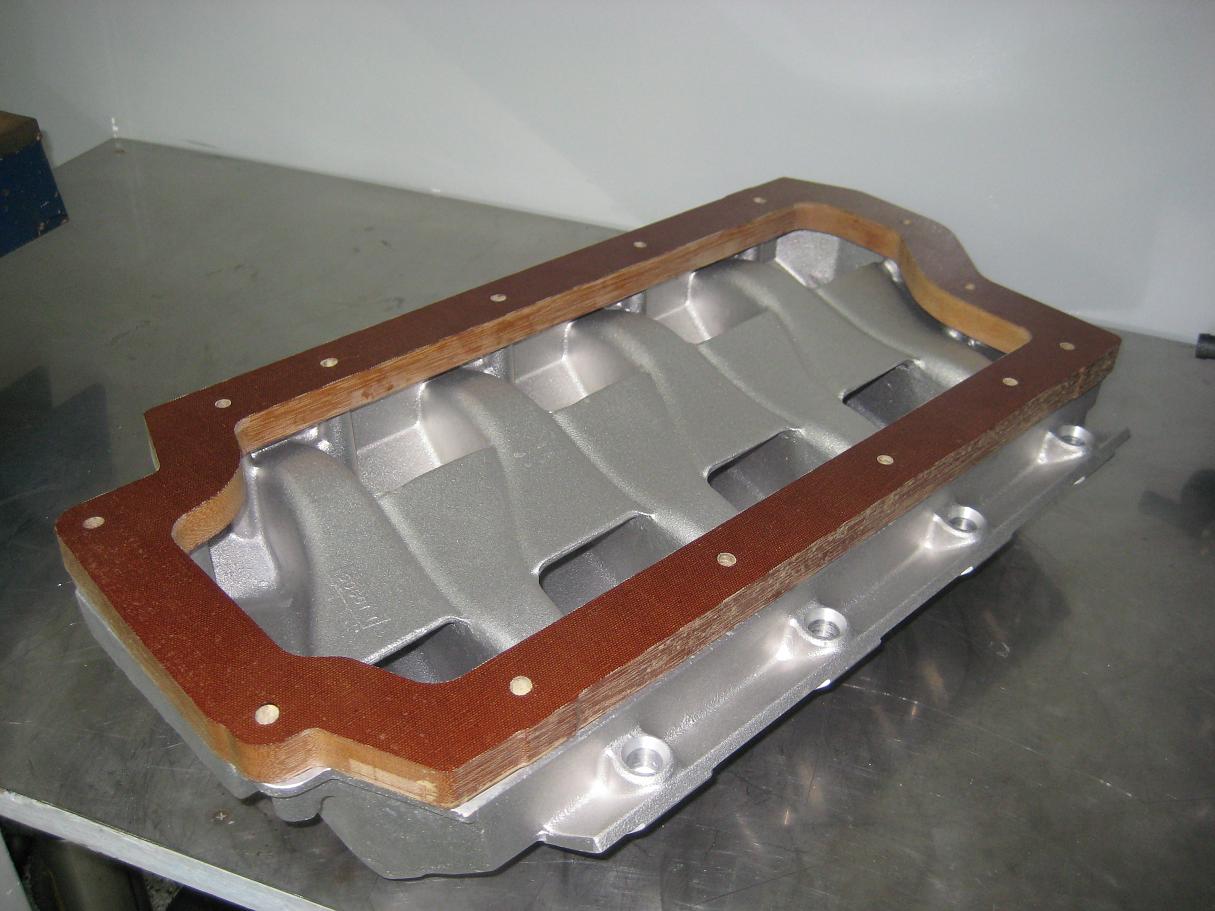

Here are the pics with the phenolic spacer on the Radix. Had to modify the fuel rails by moving the tabs upward on top of rails. Smoothed out the J-tube by doing a little porting and installed the 85mm from BBK. Looking good so far. Keep you guys posted with more as this project moves along.

when using the killer chiller the A/C has to be on correct?
does this mean that you can't use the heater during the winter months?
oh ya and iv always liked the idea of the phenolic spacer, im glad some one else is using his idea

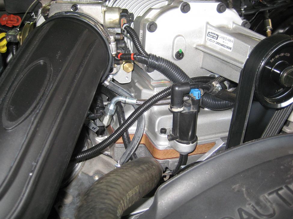

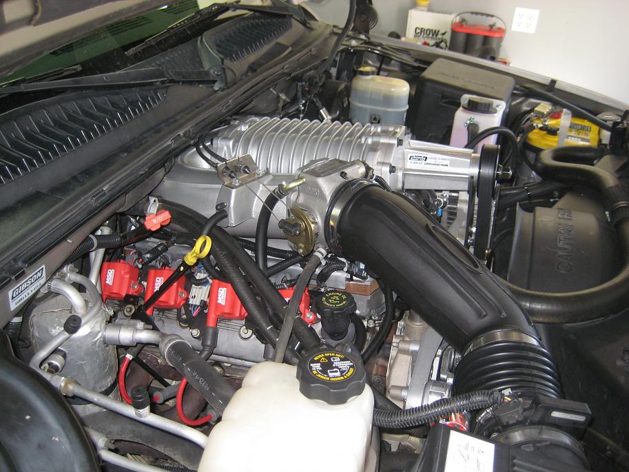

Finally finished the install. Had few things to modify but wasn't that big of a deal. Fired it up yesterday and it started up fine. This am though it had a rough time starting, called my tuning guy to set up a appointment to get it on the dyno to make sure things are good and a little tweeking here and there. Will post the numbers as soon as I get them. All in all I like the instant boost and mine was hitting 7.5 lbs of boost on my first WOT. Will see what the dyno says. Here are some pics of the finished insall.
