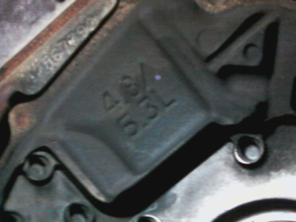

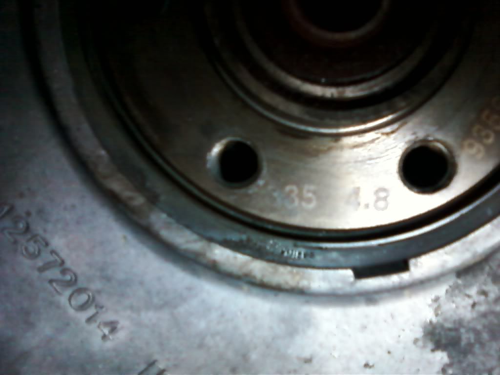

Joined: Dec 2009
Posts: 1,560
From: Charleston, SC
Originally Posted by jeffreycastgsx
All of the 4.8/5.3's ive seen have a white dash across the 4.8 or 5.3 in the back, couldnt they have seen that from the beginning?
Heres mine, no dash but a clearly marked crank.
