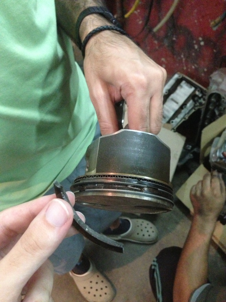

Hey post some pics of the four pistons it ate up. I'd like to see what my 4.8L will look like when i get my turbo kit installed. haha

Mini update here, we got a used engine from the junkyard and its up and running.
Here u go Jake, i expected complete carnage! the block, cylinder wall, rods and crank are in perfect condition so my brother decided to keep the old parts. All we need to do is buy new 5.3 pistons and we can reuse the old engine again.
looking at the log again the old engine went through 20 psi , 14-14.5 afr and 10-14 degrees of knock.. ouch! i made sure the boost is stable this time running 9-10 psi ill take a few videos of it soon

For the user that wanted to know what his engine would look like after he got a turbo...
Thank you sir. I look forward to that and will post pics when it happens.
