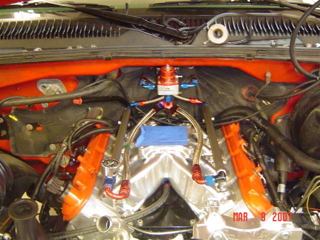

Truck is in final assembly now
Attached Thumbnails Its almost time..........-dsc02833.jpg   Its almost time..........-dsc02834.jpg

Old Mar 9, 2007 | 05:35 PM
  #68
danv's Avatar
Joined: Dec 2006
Posts: 103
From: Lynden, WA
WOW
Old Mar 9, 2007 | 08:04 PM
  #69
fullthrottledan's Avatar
Joined: Mar 2004
Posts: 422
From: Indy, IN
damn guys im jealous for sure! looks really good
Old Mar 9, 2007 | 08:45 PM
  #70
8ALTNG's Avatar
Joined: Aug 2003
Posts: 3,647
From: Methuen, MA
Looks good Don. That thing is going to f'n RIP!!!!!!!!!!!!!!!!!!
