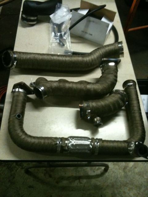

The DEI titanium wrap is fine if you never touch it after installation but chances are you will eventually have to take the hot parts off for some reason. Just removing the down pipe will put thousands of fiberglass particles in the air, on your arms and in your lungs .... You will also destroy the wrap if you need to remove it for some reason (weld in an o2 bung, etc). We have had this stuff on two different trucks but we didn't spray the wrap like some people did. The last time I had the DP off I replaced the wrap with the Jegs brand and it seems to be doing fine.
If I remember right I bought a 2" x 100' and 1" x 25' roll. I used the 1" roll on the log manifold only to get where the 2" couldn't (between the primaries and around the o2 sensor bung). Then went over the top of it with the 2" to get all of the bare spots. Also, if you do it this way don't get the wrap on the primaries to thick or it will be hard to get your plug wires off/change plugs. You can't see in the picture but I have hose clamps on each of the primaries right next to the exhaust flange.
