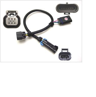

01-02 DBW trucks just need a 2 plug to 1 plug adapter harness like this one.
As stated by Stoichiometric, you might have to modify the adapter harness if you get one that was made for a car.
Attached Thumbnails installed 112, now 90mm J-tube and TB-ls2-adapter-harness.jpg
