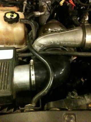

Finally found a picture.
I used 4" alum tube and ran it inside the airbox and put a bead of silicone on the inside of it and black RTV on the outside.
It worked.

Thanks for the picture that's a good idea I didn't even think to just cut it out and add a metal tube I was thinking plastic, do you know what kind of elbow you used? From the picture it looks like one of those basic silicone elbows but I'm not sure if you would need a reenforced one since this one is pre compressor and could suck in?
My main goal is just to get the stock air filter working again. I think all those thin cone air filters, even the name brand ones (k&n etc) are crap and have basically zero filtering efficiency. I want to see if I can get the silicone content in the oil back to normal since it's like 10x the normal levels although it could be do to RTV or something like that but it seems it's from crappy filters letting dirt in.

Here Here
is a cast aluminum short radius elbow.

Originally Posted by MikeGyver
Here is a cast aluminum short radius elbow.
Thanks, Ill probably go ahead and order that one and couple it with silicone couplers. But I might order a 4 in short raidus silicone elbow as well. I wonder if its pushed in at both ends good enough if it might be enough to keep it Un collapsed.
Maybe if I had to, I could tack up some rings with a brace to put in the unsupported parts of the coupler.
I did buy a U-bend 4in aluminum "intercooler" tube. My problem is I don't have anything to weld the aluminum, but I have tried low temp aluminum brazing rod on the intercooler pipe before. You almost have to melt the pipe before the brazing rod will melt and penetrate since if you try to help the brazing rod get hot with the torch it won't penetrate at all. It is very difficult, and the pipe ends have to be perfectly concentric and flat but hopefully since I ordered this expensive intercooler 4 in u-bend tube and not the cheap chinesium one then maybe it will braze better.
