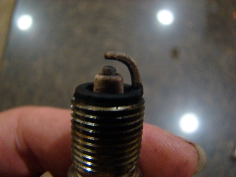

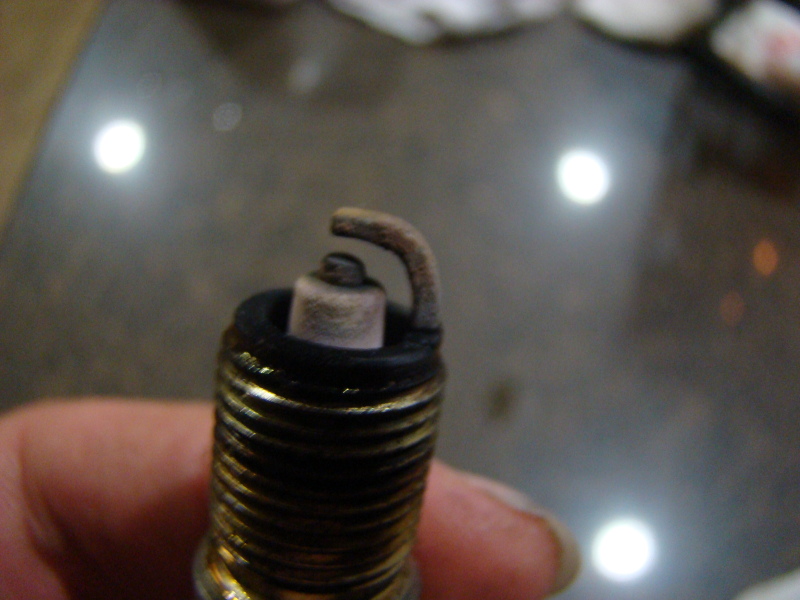

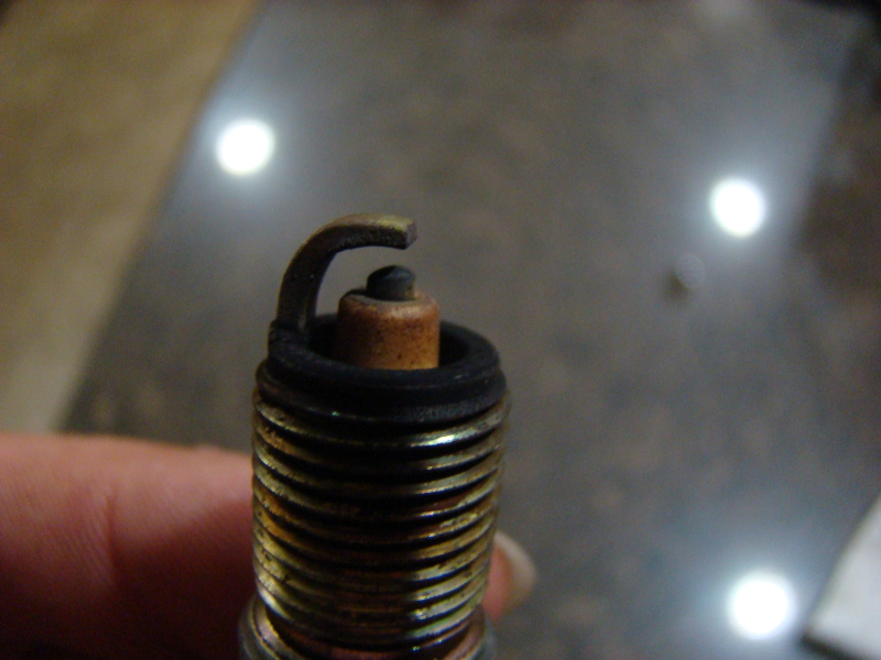

Afr wot seemed good. But at idle it pegging my gauge @ 16:1. I'll have to look at the log later tonight and see what it all really looked like. I didn't get a chance to go through it. I'll do that and post the spark plug pics tonight. Got to mow and go take kids to play at pool today.

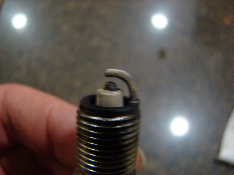

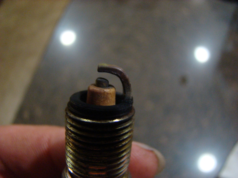

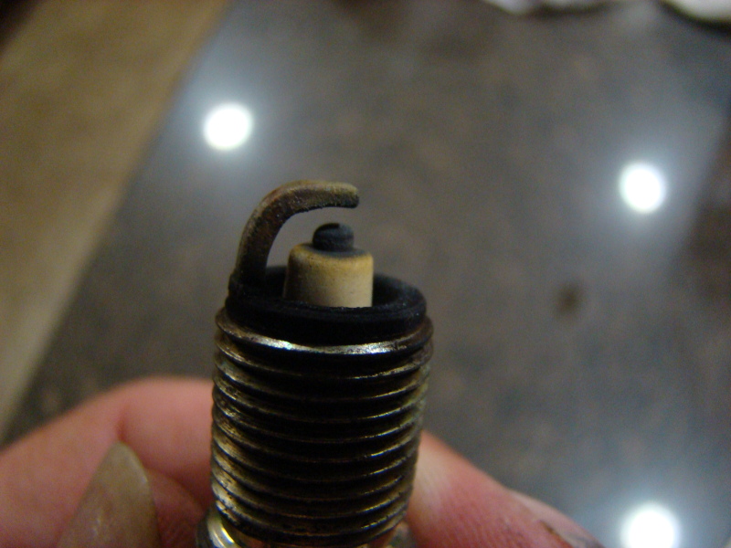

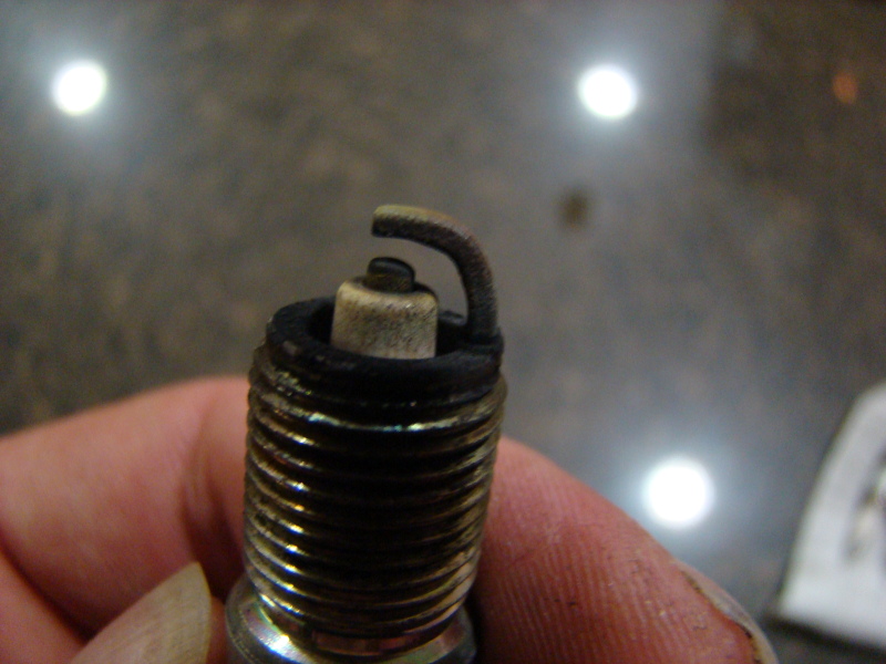

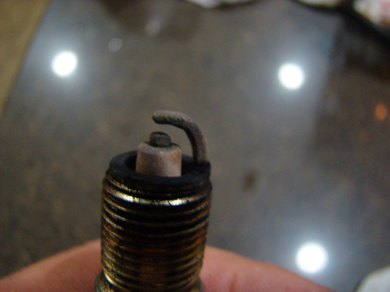

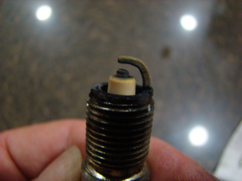

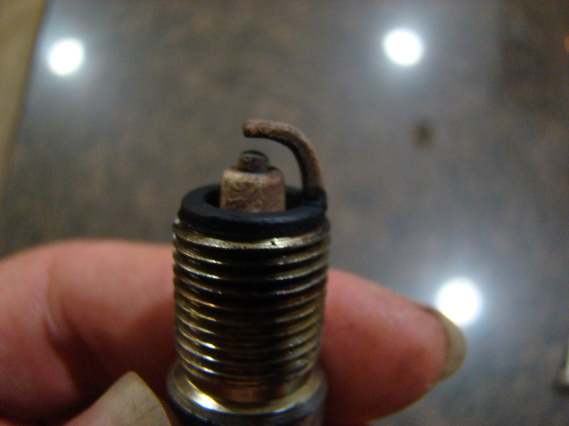

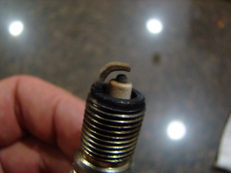

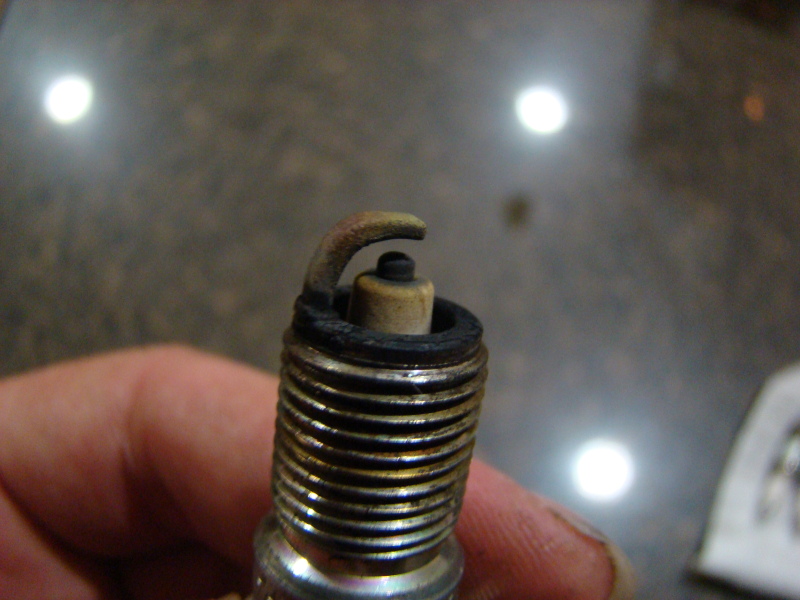

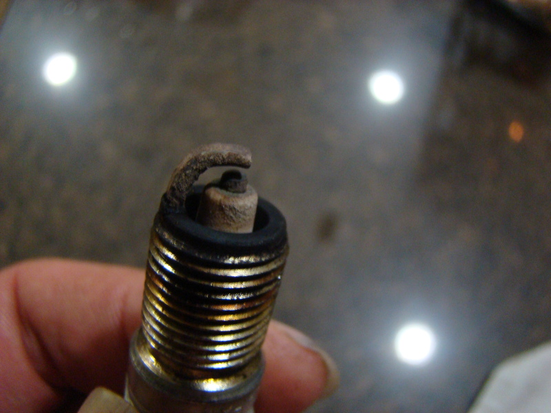

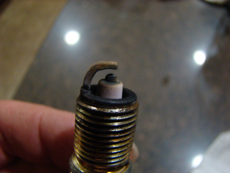

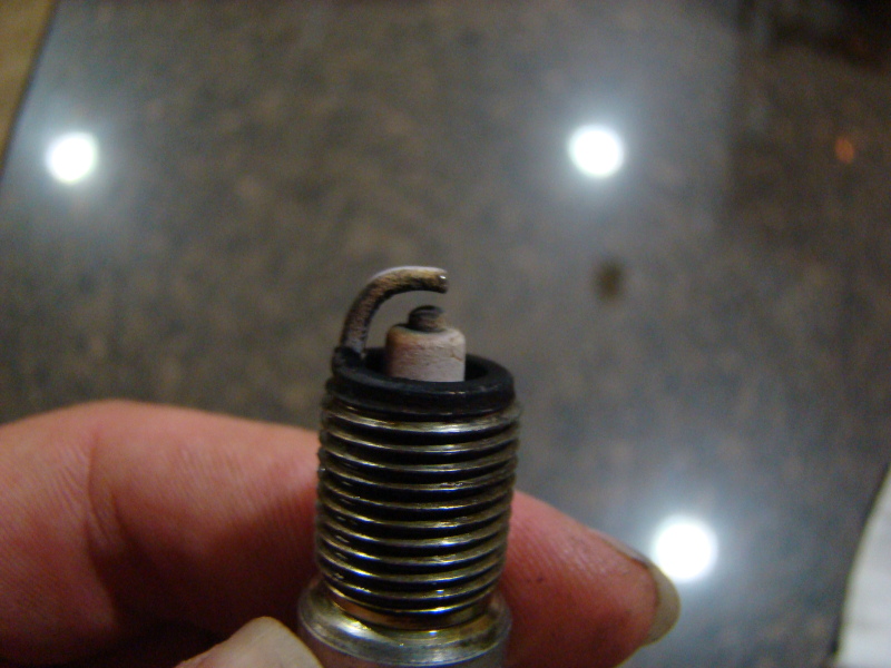

Old Jul 9, 2012 | 07:05 PM
  #26
TURBHOE's Avatar
12 Second Truck Club
Joined: Nov 2004
Posts: 6,318
From: Jacksonville FL.
Size:  168.8 KBName:  DSC00843.jpg
Size:  177.0 KBName:  DSC00844.jpg
Size:  172.6 KBName:  DSC00845.jpg
Size:  182.6 KBName:  DSC00846.jpg
Old Jul 9, 2012 | 07:27 PM
  #27
TURBHOE's Avatar
Joined: Nov 2004
Posts: 6,318
i looked at the log. it was a bust. i didn't have the right config loaded. but, there was no KR. i don't think the motor likes the plugs. my far has been good for two years plus. now all the sudden its sky high and nearly idles and part throttle is high as hell too. this tells me that its wasting fuel and not burning it all. my mileage seemed to be way down driving around also.
here is what i think and see if you guys would agree. about a week ago i was racing a friend. during the race i noticed my meth light went out. turns out it had been out the whole race. it ran fine but was down on power. come to find out the boost reference line cracked and blew off. which took out my high boost reference and made a boost leak.
once i got home and found the hose and fixed it everything in low boost was back to normal. but i think during that run it burned up the plugs. not to mention they were old as hell.
when i went wot after the plug swap it just didn't seem to pull like it use too. it didn't stutter or anything. high boost now feels like low boost before the plug swap.
Old Jul 9, 2012 | 08:44 PM
  #28
holley2346's Avatar
Joined: Nov 2011
Posts: 189
From: Montgomery, Al
I swapped in br7ef's from tr6's and noticed this "lack of power feeling" that you are describing. I went back to the tr6's. They are doing fine at 12 pounds.
Old Jul 9, 2012 | 08:58 PM
  #29
03sierraslt's Avatar
Posts: 19,007
Likes: 221
From: Western PA
If you are going back to 6's then use a BR6EF, you have meth? Those plugs look like ****, check the gap on them and see what it is. I am running BR6EF's at 12psi w/meth
Old Jul 9, 2012 | 08:59 PM
  #30
Posts: 19,007
Likes: 221
From: Western PA
I am really curious now what your AFR does if you switch back to a BR6EF and dont change anything else.
