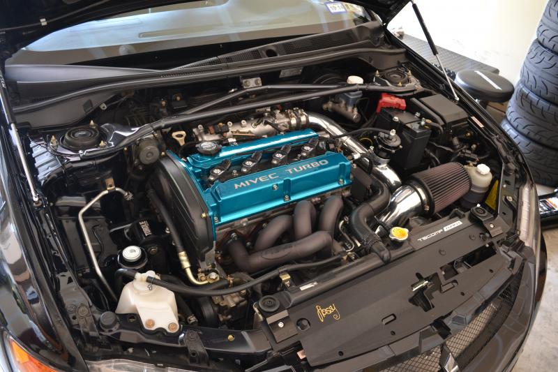

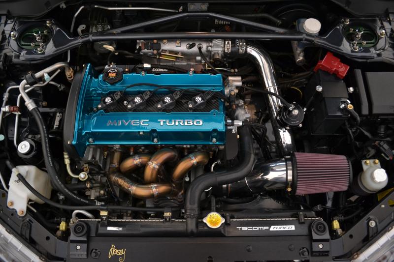

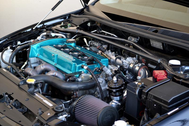

There's a local guy that does ceramic coating in 2000° black. I had him do my old car turbo manifold after the stainless blued and looked like crap. It was also hot as **** being bare stainless, so this coating helped with that. I considered having this guy so all the parts including the drivers manifold. BUT I've also heard negative things with wrapping ceramic coated pipes. Supposedly it needs to be one or the other, but not both
after first startup, looked great:
then it turned blue and looked like ***:
after coating:
