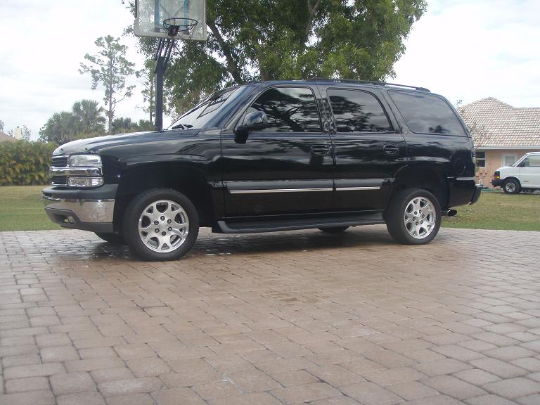

NORCAL TBSS ..... I run 275/45/R17 MT ET STREET Drag Radials on the factory Z71 rims at the track (Looks Funny) and 305/40/R22 on the street. I travel alot on the highway and I dont want to lose alot of gas milage. I heard 3.42 to 3.73 was worthless but is 3.90 worth the swap. 4.10 I heard eats 2-3mpg more.
