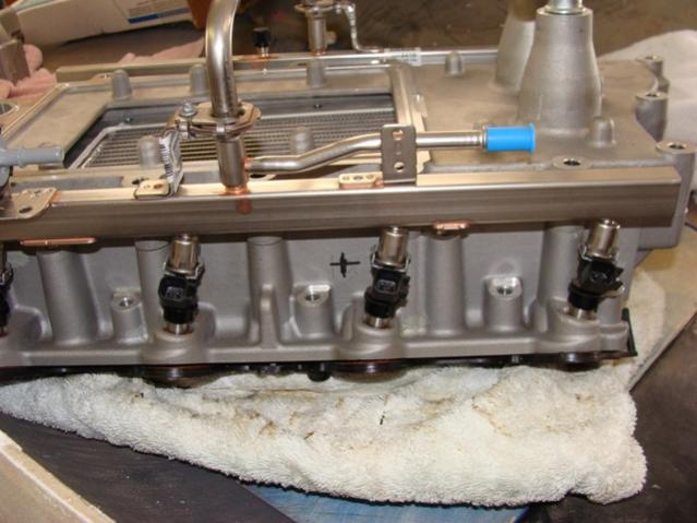

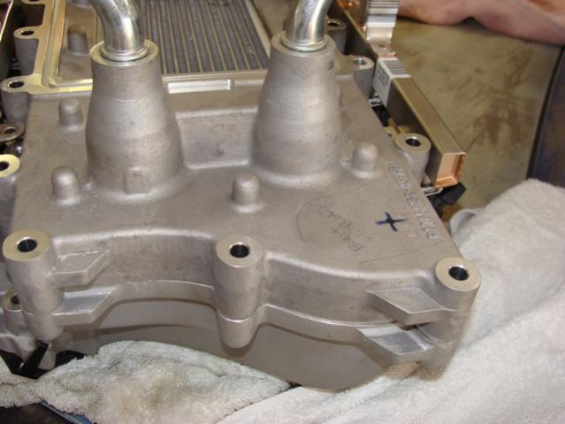

There is tons of room in the lower manifold to drill from the out side and put in an IAT. The lower tub is much bigger on these then the Maggie TVS 1900.
Would it be better to put it on the side, in the lower half of the intake. The + in the first picture. This is where I'm thinking it should go. I'm pretty sure this is close to where it is on the maggie
Or in the back corner of the top half off the intake(second picture).I was gonna tap a fitting for the boost gauge in this spot.
Any thoughts?

So is this the style of IAT sensor that we need?
http://www.diyautotune.com/catalog/o...tail-p-62.html
That's the one I bought.
So did you decide where to mount the IAT sensor? I think I'll mount it on the side where you pointed out. I'm installing mine this weekend and I don't have the sensor yet, so I think I'll drill and tap a hole and then plug it until I get the sensor. Also do you know how to wire the sensor up?
I figured it out, looks like you cut the tan and black wires on the maf sensor and connect there.
That's it.

Installed the temp sensor so I can run the stock map sensor. All seems well.
Just enough space left for a boost sensor later.
Was able to pull the blower and upper intake off without messing with the fuel rails, thankfully. Made for a quick job
Installed
This officially finishes the install. Any questions, let me know
