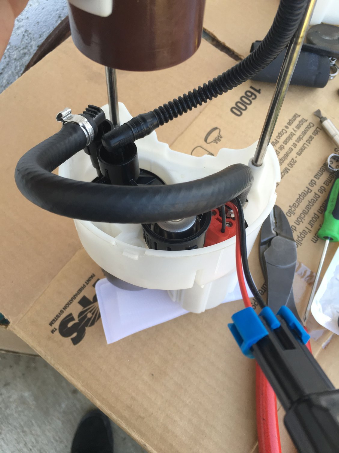

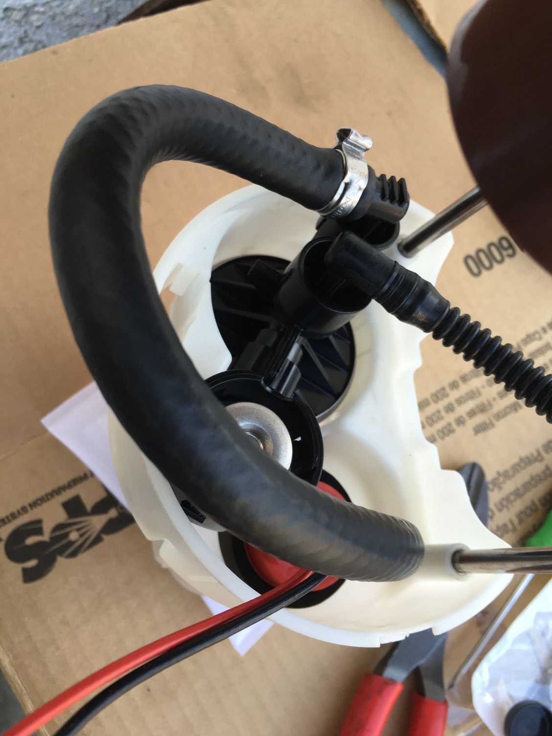

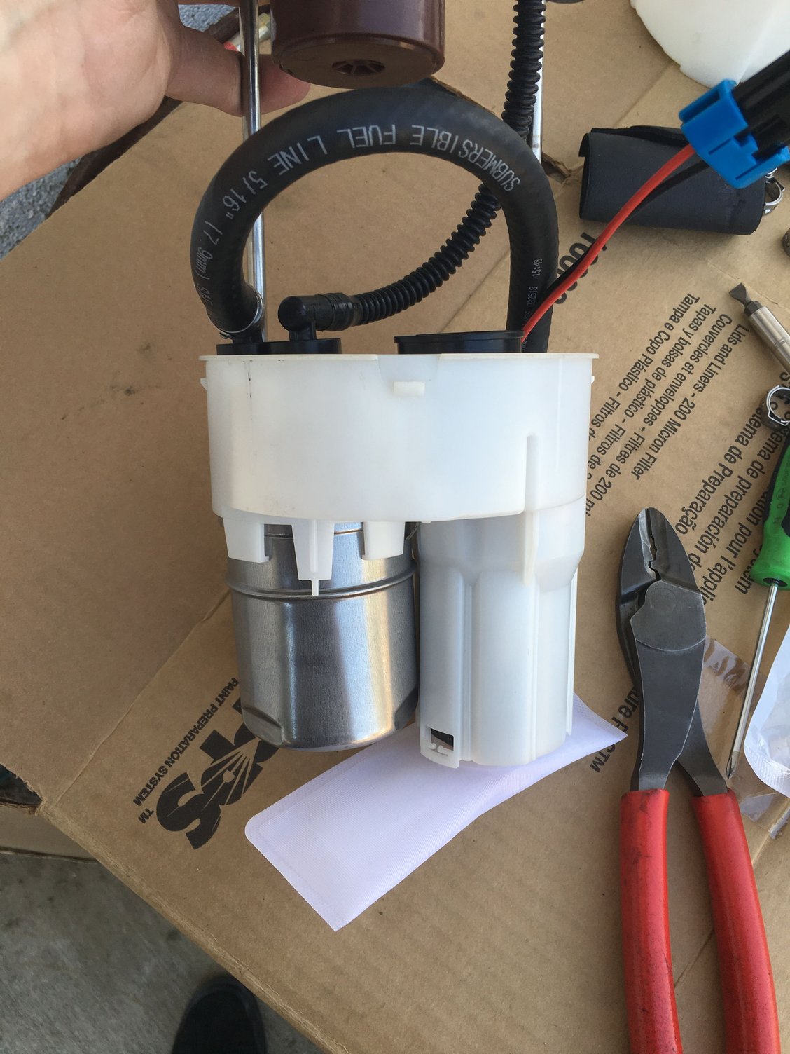

So got the aeromotive 340 in today, and installed it in a brand new Delphi bucket, just so I had a fresh regulator and filter. Made my own Hotwire kit, 10awg from the alternator, 30a fuse to a relay, the out directly to the plug on the pump, triggering the relay from the stock voltage supply and ground, and then ran a 10awg ground off the oem to the plug to the frame. Everything works great, but it still seems to be dropping a bit of pressure. At idle/cruise it holds 58psi, and then when I get into boost I'm seeing about 52psi. The truck is an 07 classic so it's returnless. I mean as long as it doesn't go lean, I should be ok with 52psi right? I mean right now I'm seeing 11.1 on my wideband

its probably cause its not boost referenced mine did the same thing until i did a boost referenced FPR
your gonna need to do a return setup sometime down the road you'll be better off

Yea a little bit of drop is normal. It's fine. You can correct for that by fudging the VE table a little. A 340 can definitely handle the power you are making in a returnless system.

Yeah I've been scratching my head all night thinking I did something wrong, but all my research has come to the conclusion that returnless sucks and I will see a pressure drop. Tune it getting finished up Tuesday. So we will see what comes of it.
Also for anyone thinking about doing the 340, it fit great in the returnless bucket. Use pinch clamps, I think my 255 actually was fine, but I used worm gear clamps on it before and noticed that they were basically hand tight. I went to Lowes and bought some Apollo 3/8 and 1/2 pinch clamps and they are tight and should never come loose
