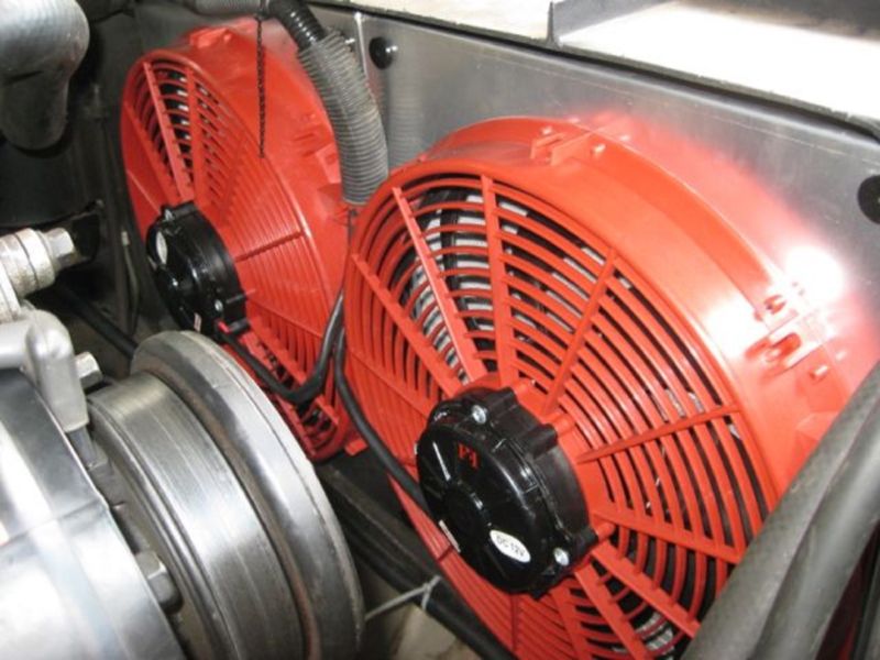

Stock hd have a 34 inch radiator, the clutch fans do work very well. When stopped tho I needed something more. I did a set of ffd high cfm fans. They pull about 1500 cfm more than stock silverado fans. They have a full aluminum shroud that fits the 34 inch radiator perfect. With using a pcm of NC harness and the pcm to operate them. I can keep the temp down to basically whatever I need. Right now I have the 194 Stat in and temps don't leave 204 when beat on.
