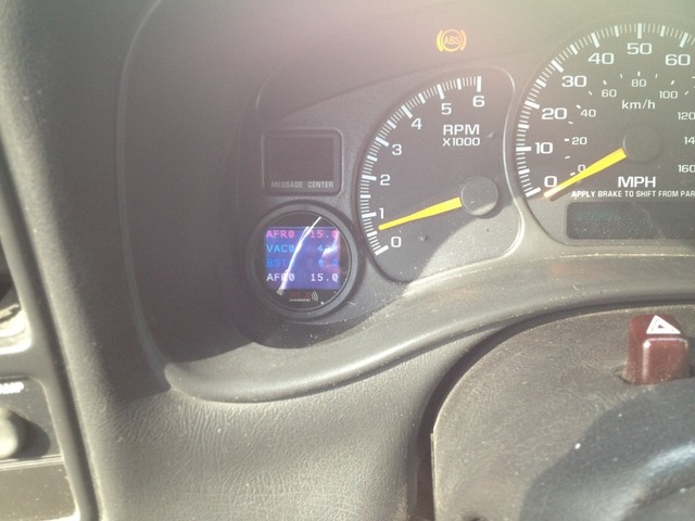

Great ideas guys thanks. Hey Brent1976 could you post a daylight pic of how that is sitting with your gauge cluster? That looks really good.

Originally Posted by brent1976
That's really clean I like how that is set up you have pics of install process I'm curious to see how it was done

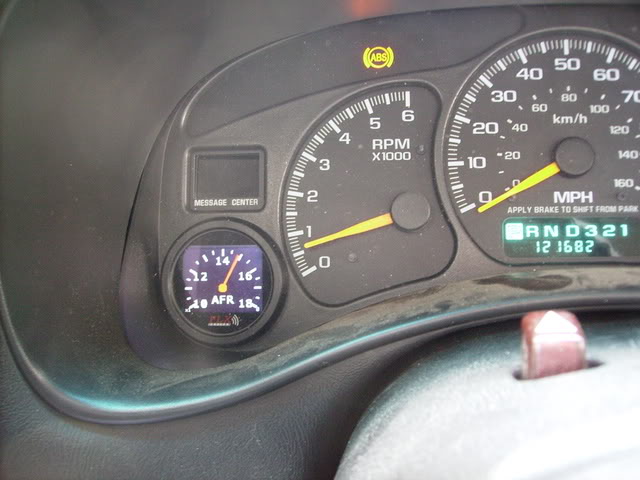

No pictures, but it was pretty simple. I don't remember if someone else did a write-up, or just put pictures of theirs mounted like this.
I pulled the dash apart, took the bezel out. Then took that apart, and drilled a hole with a hole bit. There is copper foil/solder there, but it is for a factory trans temp gauge that isn't there, so I drilled through it. Then you have to cut a hole in the back cover of the bezel for the wires to go through, and that's it. It took me less than an hour.
