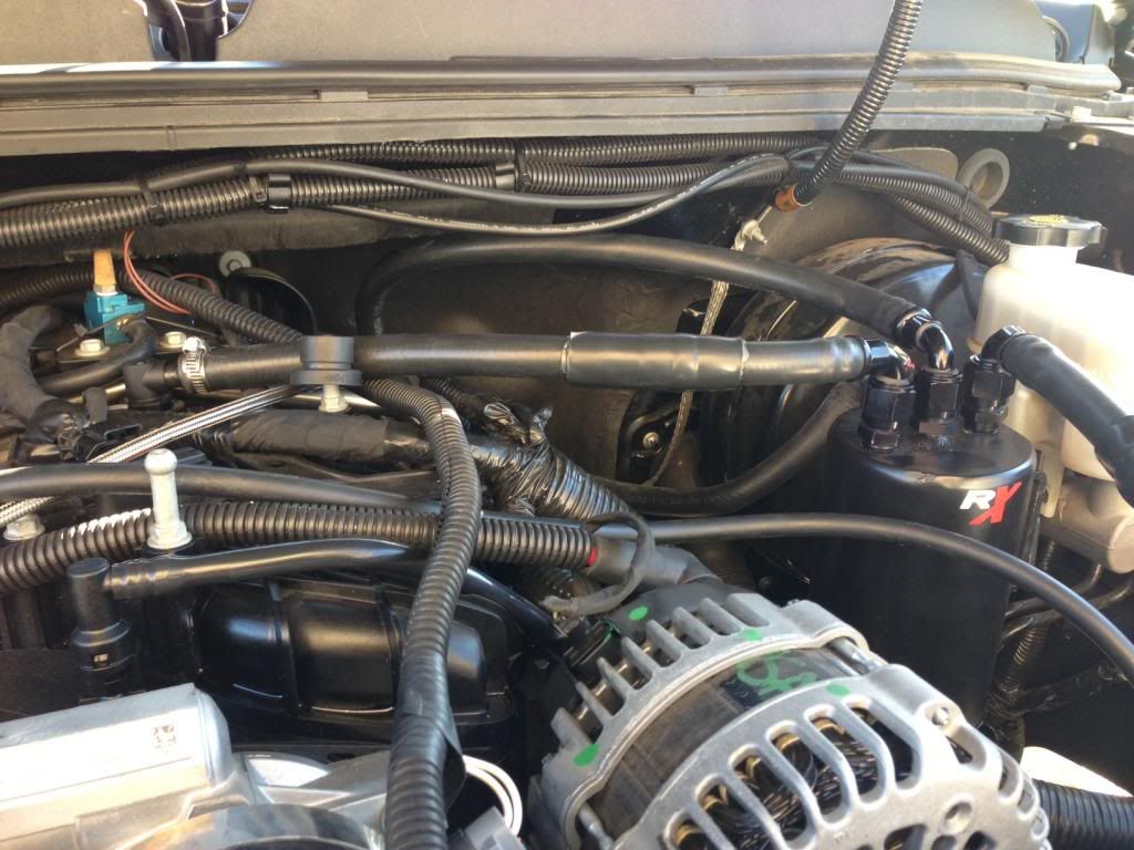

I called Rev Extreme, and the owner walked me through the thought process of their catch can and vent system. My truck was smoking on decel, and after buying their boosted application can, then hooking up the hoses like they suggest the smoke was gone.

Same here. Rx can is the best out there for boost IMO

That Rx can doesn't look vented. Where is the crankcase pressure going under boost?

What do you do with the pass side? That looks nice and clean.

Put a filter on the oil fill cap so it sucks clean air through the motor. That can is setup with 2 check valves

If I remeber correctly it vents back through the front side of the turbo under boost, as there is a vacuum created when the turbo is spooling. The guys at Rev Extreme can answer all your questions on how a proper boosted PCV system should work. My conversation with them was a learning experience.
