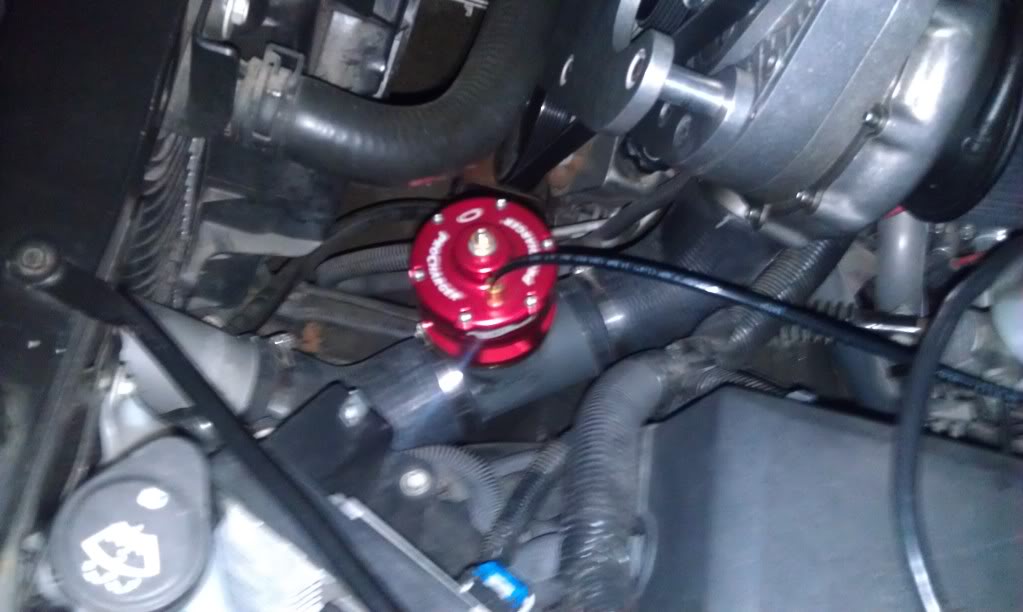

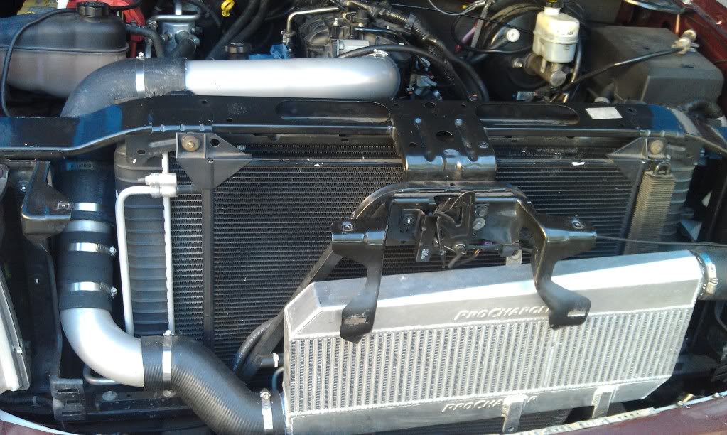

This is my old P1 kit with a 3 core intercooler, I'm currently doing another one but with the Houston of boost bracket, I'll post pic tomorrow.

cool. thanks thats what i was looking for.
