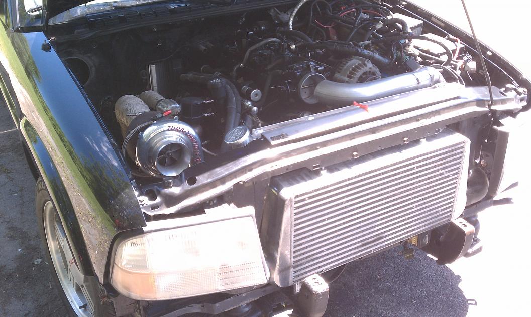

Got a bunch of parts coming in everyday. its like Christmas. lol. Got the cross member cut to clear the pan and plated it all back in. Waiting on the turbo the come in so we can start the fabbing. Ill get some pics up soon of the progress.
