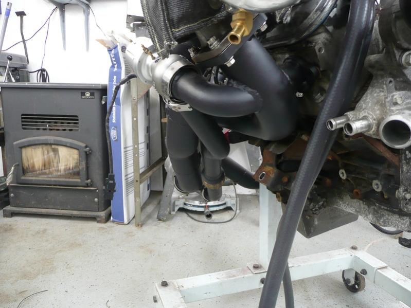

Wastegate should have some priority in the system and ideally as close to the turbo as possible. On these trucks it is 300 times easier to plumb it from the crossover and join it back into the down pipe 2 ft after the turbine flange so it is the way you will see it done in most cases. To route a separate pipe from the turbo area back down and have it enter the downpipe away from the turbo was a pain in the *** and I don't think it was worth all the trouble.
