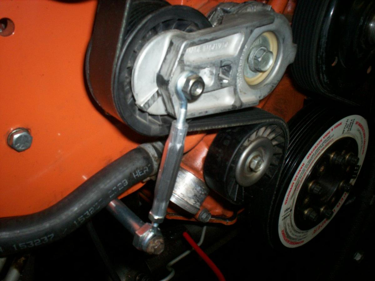

I had an isssue at times with throwing the belt at WOT between shifts. I bought a new Dayco tensioner, but still had the same problem. Fixed the issue for $4.
