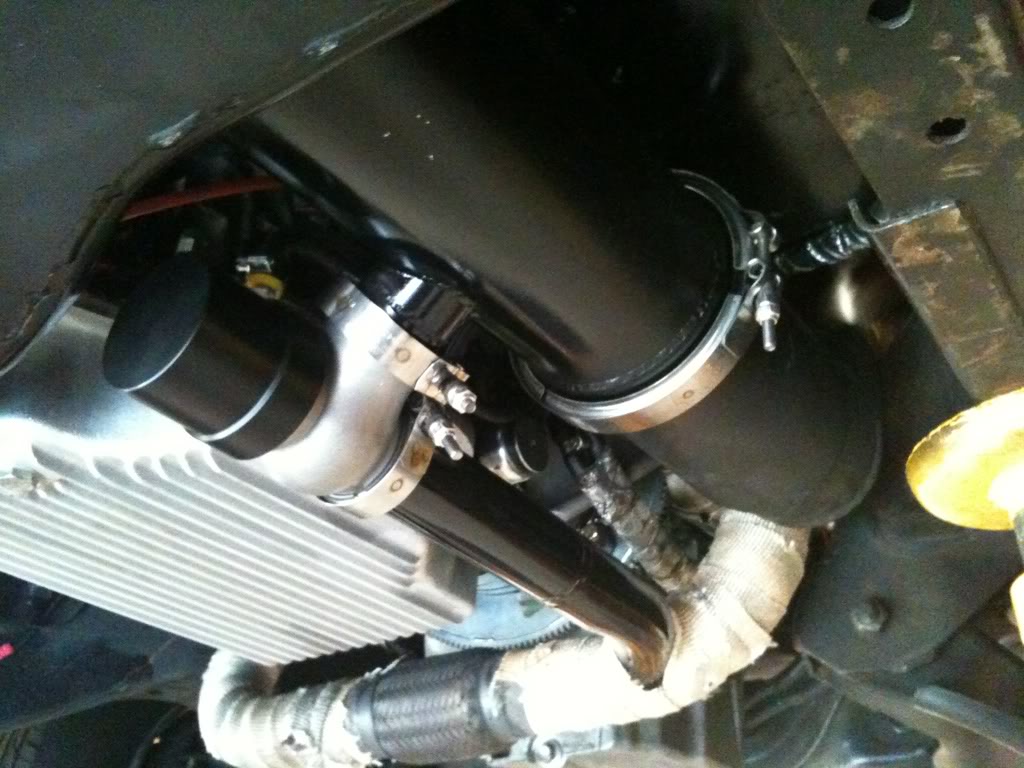

anyone install their wastegate like this?

i had mine like this on a single 60mm wastegate log manifold setup and worked pretty well for street use with my manual boost controller

Why is a psi sensor in the top port of the log gate?

That reads the psi behind the gate for the AMS1000 boost controller.... so when i put x psi of co2 behind the gate it will run x#'s of boost.... it actually has a T where co2 goes into the same fitting but this picture dosent show it
