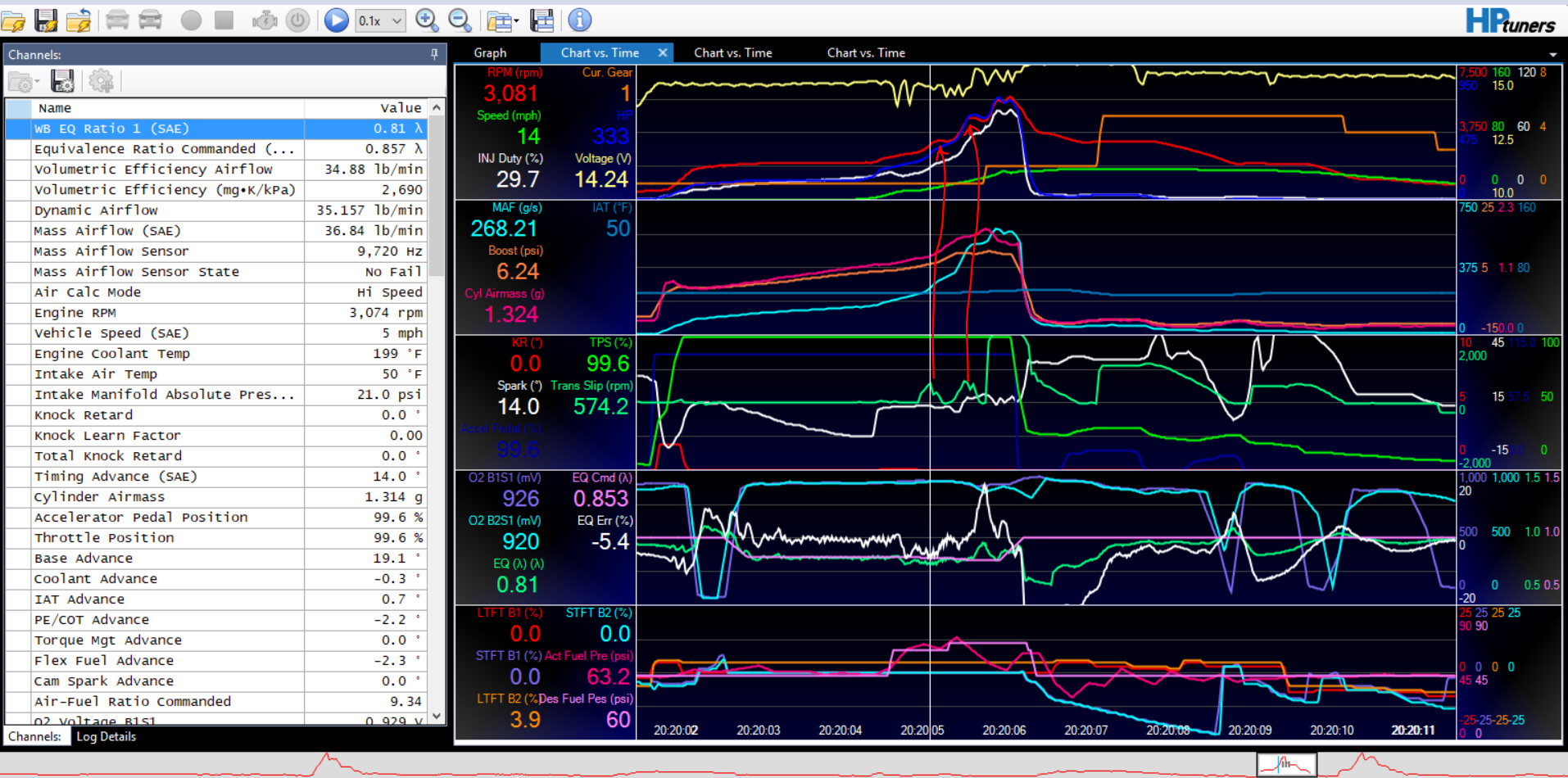

So I am not sure how the trans slip PID works or if it counts it in second gear when the on coming clutch is still slipping but the RPMs are still increasing and not decreasing. But the 1-2 shift I think is different though since I believe you just have one on coming clutch (2-6 clutch) coming on and no off going clutch to handoff. But during the 1-2 shift in the logs you can see the trans slip PID start ramping up past 1000rpms right after the log says the current gear PID changes from 1st to 2nd and the RPMs are still increasing and it hasn't hit the RPM limit yet. So technically if there is just a on coming with no off going clutch I would think you would only read trans slip only once the RPMs start decreasing since in the logs the RPMs have a linear positive slope all the way up until the shift RPM and it seems if there was actual slip it wouldn't be linear.
In this log you can see the points where it slips correspond with the RPM blips, this one got up to 574 RPMs of slip:
So, this slip is occurring before it indicates the current gear is 2nd gear. It seems like most people are never worried about clutch slip during a single gear but only worried about it while shifting. During shifting it seems fine though and will meet the shift time I commanded in the cal most of the time. Sometimes randomly it will shift a little harder than usual but none of the gears seems to slip at all during the shift. My 6L80 is completely stock with what I believe to be the original transmission with 270k on it now but like I was saying I did replace the rear planetary after some of the teeth got chewed up but since all the clutches and bushings looked good so I didn't bother changing them and put them back in, I did put in a Sonnax zip kit and a Sonnax pressure regulator modified boost valve, spring, and bushing. It seemed like this didn't do much of anything though. I don't believe we really have any way of boosting the pressure on the 6L80 with HP Tuners besides faking the torque model. I am also using a LS9 ZR1 Corvette virtual torque values.

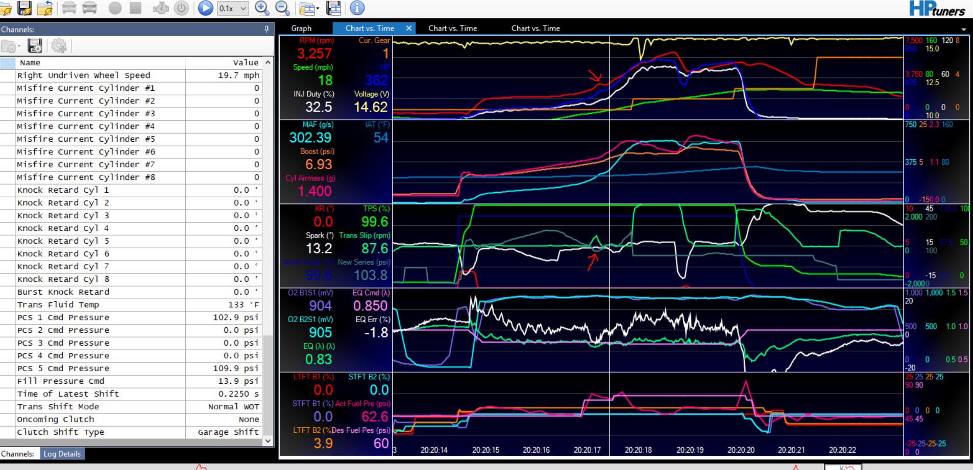

Here is another 2 psi "light" boosted launch. You can see an RPM blip and the spike in trans slip PID at the same time. What's funny is it looks like the transmission is doing this on purpose because at the exact same time it ramps down pressure control solenoid (which I believe runs the pump) to around 88 psi where it started the run at about 138 psi:
This one is also at lower RPMs and well below the 1-2 shift change indicated by the log. I know wet clutches are pretty durable and are designed to take some slip as long as you keep the heat down(especially the TCC it think which by the way I think for sure that one is starting to slip and they are of course famous for it) but I feel like this will eventually kill the clutches pretty fast. I tried to look back at my logs when it was stock and see what the trans slip was but I never logged it at the time.

Did you increase the MAP estimated max? If not it won't account for boost in the torque calculation. Won't react to the extra torque til its slipping.
