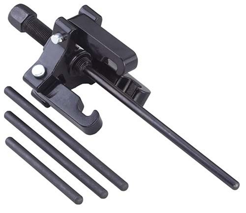

Originally Posted by Coban
Getting it off is easy if you use the Chrysler style puller.
I always hated putting it back on more. There are a few install tools that are sold on LS1tech. Don't use the bolt and you should be fine.
New gaskets, or re-using old? You seem like you would get new.... Just remember to put a dab of RTV in the corner where the oil pan and timing cover meet and you should be fine.
I'd wondered what the Chrysler puller looked like til now. Looks beefy. I should be able to find a puller or 2 in one of the drawers. If not, I could prolly rent 1 from Autozone, since they're only a mile away. My luck, if I don't have somethin suitable, I'll need it when they're closed.
Yes, I ordered all new ones from Scoggin Dickey. I meant I didn't wanna pinch any gaskets, cause I don't have the fancy Kent Moore tools. Like the timing cover seal (I might have the name wrong, but I think ya know what I mean). Sometimes u have to work w/. what u have. Regular air & hand tools aren't any concern, it's just when u get into some of the specialty tools.
Any kind / brand of RTV in particular, or does it not matter? I didn't know if it mattered, but wasn't sure if I had to use Copper Permatex or whatever color, due to not freakin out sensors if even the tiniest residue finds its' way where I don't want it to.
Originally Posted by guero68
I just used a regular 3 jaw puller....cut the flange off the harmonic balancer bolt...inserted the bolt back in to protect the threads....put the puller on and pulled balancer right off...and then remove the old bolt
to install:some guy on LS1 Tech was selling a bolt and washer set up for like $20 worked fine
Thanks for all the tips guys, I appreciate it. I've got a couple harmonic balancer install / removal tools, so I think I'm good there.
