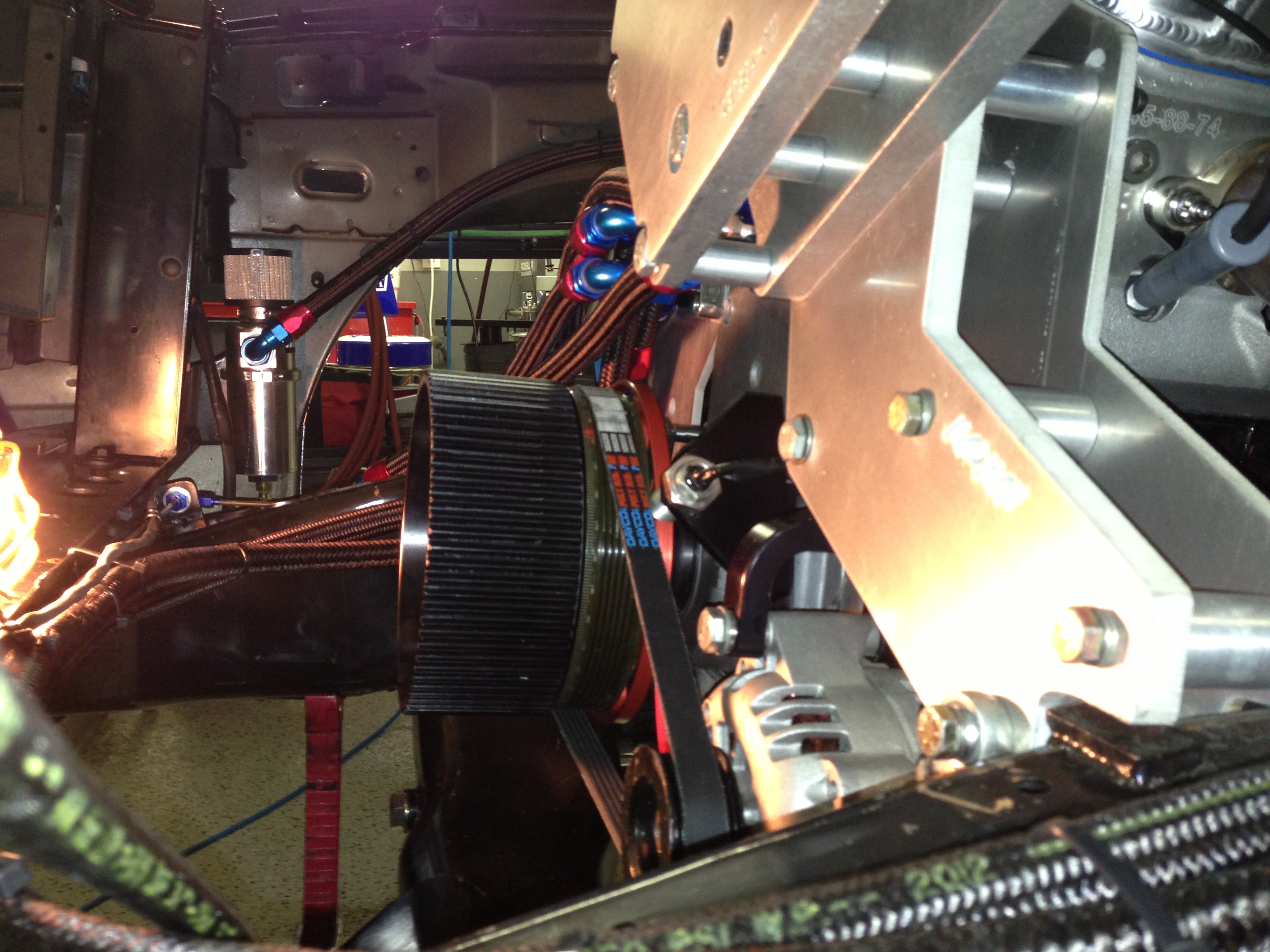

Thats cool. I've been running 2 1qt billet pieces but I forget what brand. -12 off each valve cover to them. I'll be selling these as they are too heavy.
You can see it in this pic tucked over on the left. There is another one on the other side of the truck in the same spot but I can't find a pic of it.
