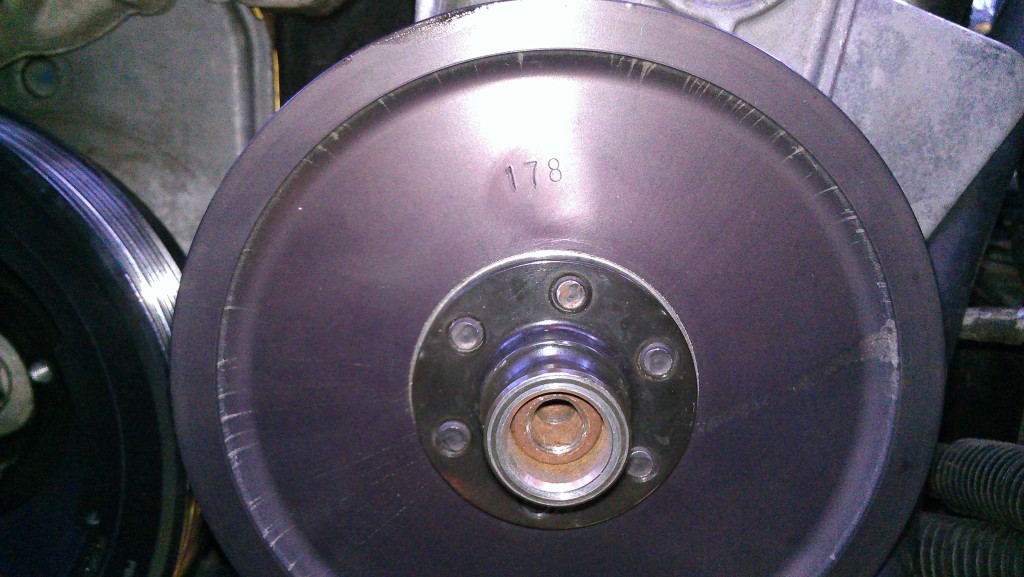

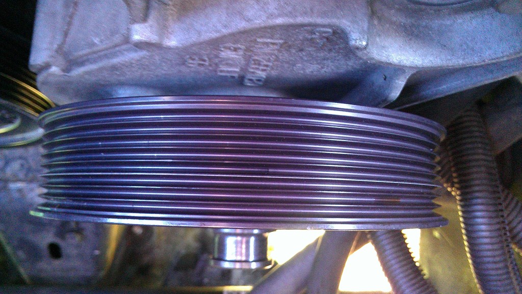

Here is my Pwr steering pulley. I had removed the bracket when I pulled the head, so that's why it isn't lining up. But you can see it. Let me know if you want more pics.
