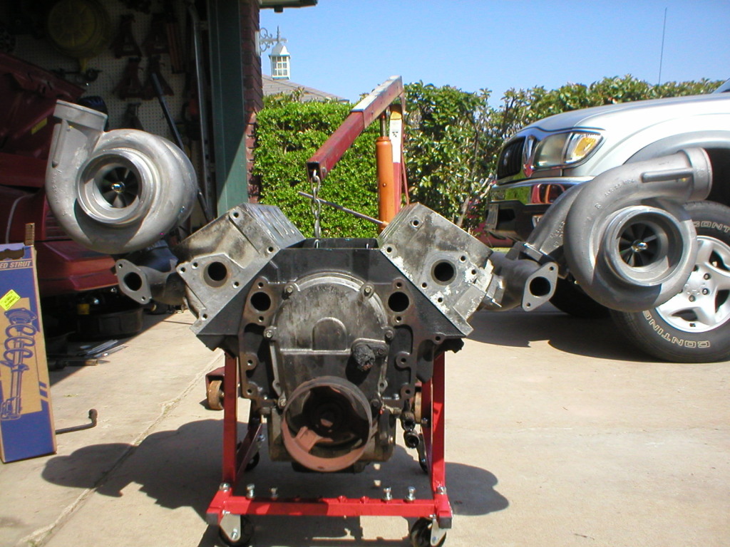

so this is overkill?

HAHAHAHAHA!!! Those manifolds are really cool!!
