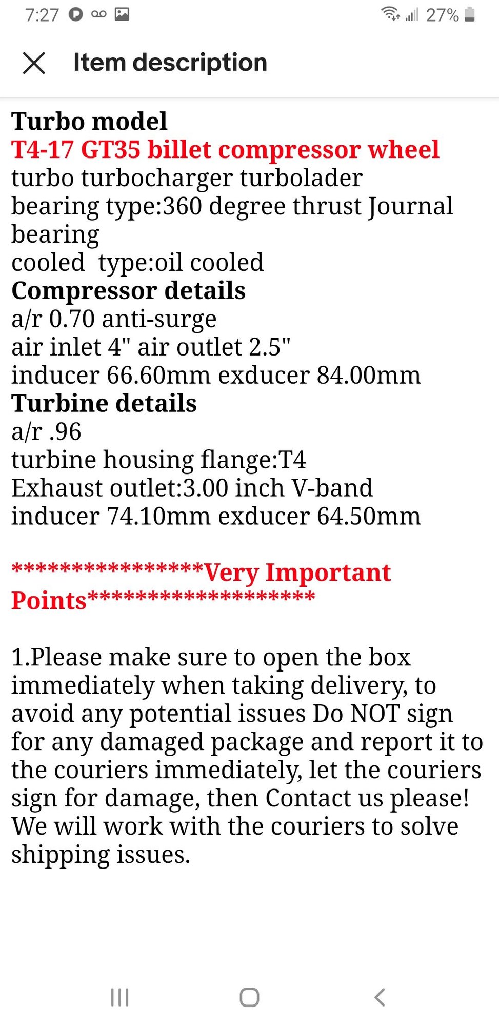

attached 3 turbos I'm trying to choose for my 6.0L. Rings have been gapped, running Eglin 1840P, 317 heads. Engine will be for a street truck. No strip application. All turbos have billet compressor wheels. Heard the twin gt35s choke a 6.0. Also dont need 1000rwhp. Just a donut machine and grocery getter. This is for twin application. If you have a better option please post lin . These are all around 250$ a piece. So do not tell me borg or Garrett

They are all pretty much gonna choke on a 6.0. But you said you aren’t chasing big hp. Any of those turbos as a pair are gonna make 750-800 hp which is more than you will ever need for Your goal. Vs racing makes s300 knock offs that have been over a 1000hp as a pair and are in the mid 300 dollar range. If it was me and from past experience you say 1000 is not the goal now but everyone wants to eventually turn it up cause you get used to the current power level. So to me a few hundred more dollars at the beginning saves several hundred when you get bored.

But if you are dead set on one of these 3 I would go with the second one
