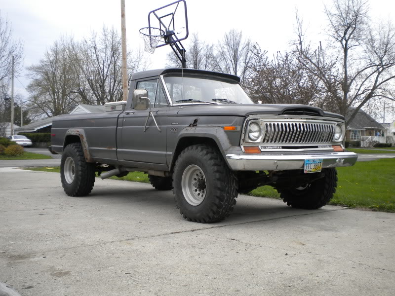

This is the truck the engine will be going into
Am I way off on my ideas or is this something that can be done.

Yes stock heads.
They were saying that the truck will be pointless before 3rd gear being a manual. And that it will have no power till the turbo lights up. I don't plan on running a huge turbo i think there just hatin more then anything but they keep saying do and cam and tune to get the power I want.
The truck is a 1979 AMC Jeep J20 factory 3/4 ton. 360 4spd
Joey- that's what I was looking for. I still want to be able to tow my camper on the weekend to the lake and occasionally my LS powered YJ to the off-road park.
