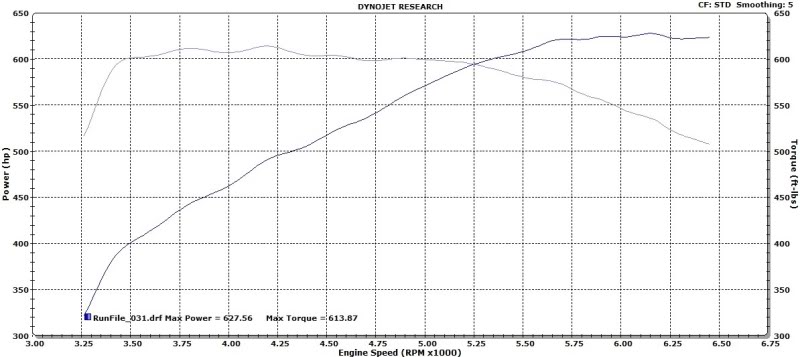

If you want big block tq down low with a stock long block your going to want to do a roots blower setup .
Here's an old dyno pull on mine .

Remember also that the ecoboost has ( correct me if I wrong) electronically controlled VVT turbos .
A twin turbo 4.8 would be awesome. Don't get me wrong , but if you want low end grunt I don't think it's the correct way to go for that . They like to be revved and like said while in boost your mpg goes to hell .
