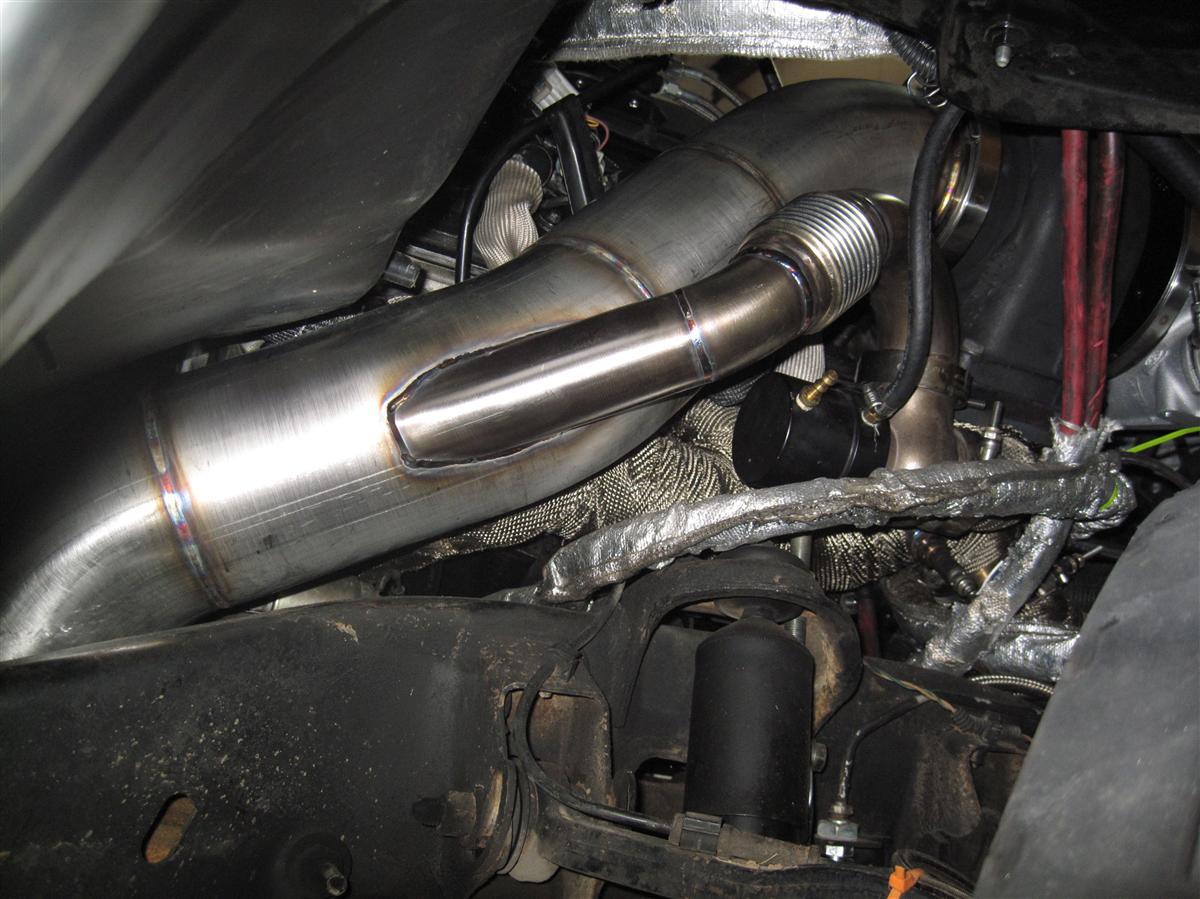

i was gonna see if anyone else has a 5" dp if they can give me some pics to get ideas from and tips would help. thanks
Old Mar 16, 2014 | 11:58 AM
Atomic's Avatar
I have a gauge for that
Posts: 16,282
Likes: 438
I wouldnt worry about a 5" dp unless you have a 400ci or larger engine. Plenty of 6.0 guys make good power on 3.5" downpipes, so a 4" would more than suffice for most setups.

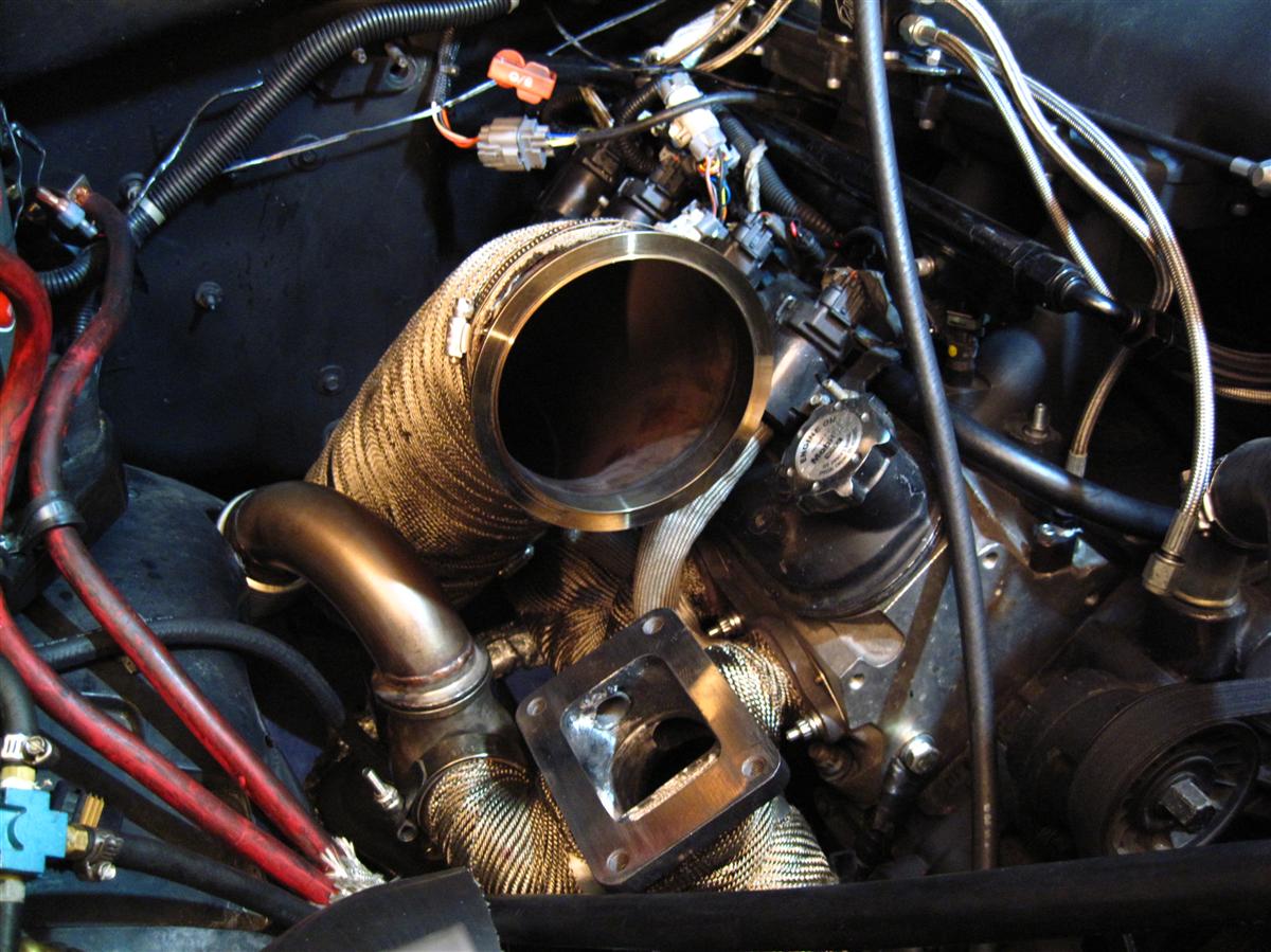

making hotside im gonna finish welding this week and hopefully be working on downpipe this coming weekend that way i can order some stuff if i need to 5" v band ect.
