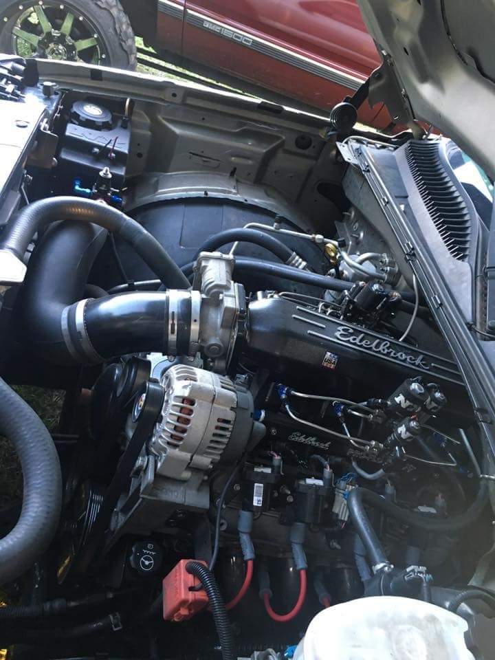

About to purchase a 408 Nitrous truck. It had 11:1 compression is that too high to turbo?
I've been talking with a few tuners and they recommend me doing a piston swap to lower compression before I turbo it.
Any advice?

Planning on 93 and meth, it's a Thompson motoraports 408 short block with trick flow 215 heads.
Truck will be a weekend warrior at the 1/8th might get 50 miles a week.

I ran an 11:1 408 with a tvs1900 before, and it was a torque monster and very fun to drive although. Not a great track performer but probably the most fun combo I have had. The little blower only made 6-7psi of boost, which is about the most I would recommend at that compression and pump gas.

So I should just do a piston swap to be able to run more boost with the turbo setup ? Or would e85 help with the compression and boost?

E85 would help some, but what are your plans with this truck? As it is would be fine for a strong daily driver but if you want a race truck that you want to run on pump gas with a turbo then yea you need to lower it. Right now though if you aren't stuck on a turbo just throw on a 150hp nitrous kit and let it eat.
