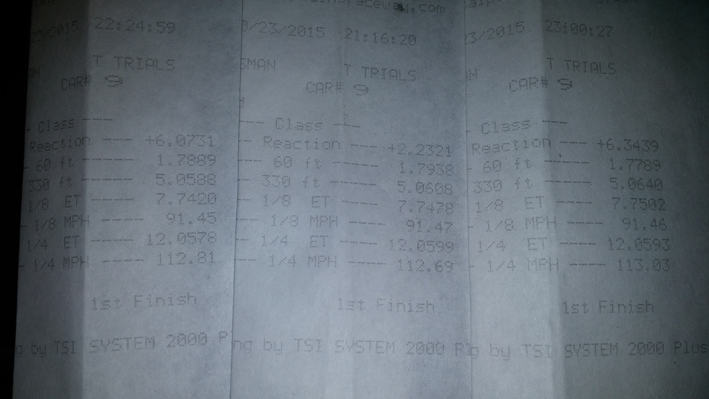

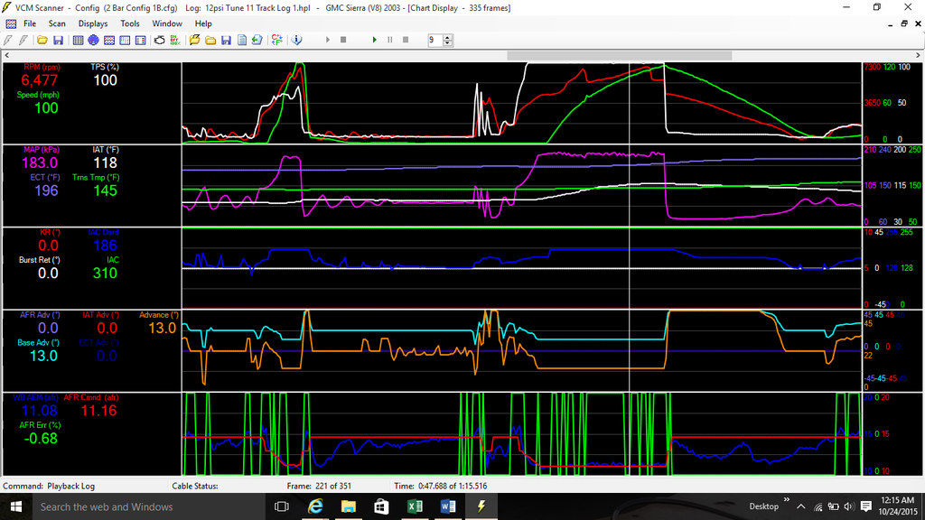

So, I made it to the track tonight. Had some interesting results including a new PB of 12.05sec@112.81mph w/1.78sec 60ft. Ran three 12.05sec quarter miles...the timeslips are almost identical. Did the math based on the tune and I'm at 35% converter slip which explains a lot. Each of the 3 passes was on 13 degrees and 13.5psi or so. 1st two passes I left at 8psi on the 2 step at 3400 rpm, 3rd pass I left on about 12psi on the 2 step at 3600 rpm which did not result in any quicker of a 60ft time.

So new PB but need to figure out the converter. I'll get up with Circle D and see what they suggest. I attached the current log, tune, and config if anyone is interested. Thanks for looking and all of the help!

Lock converter and then measure slip thats what multi disk are made to do
