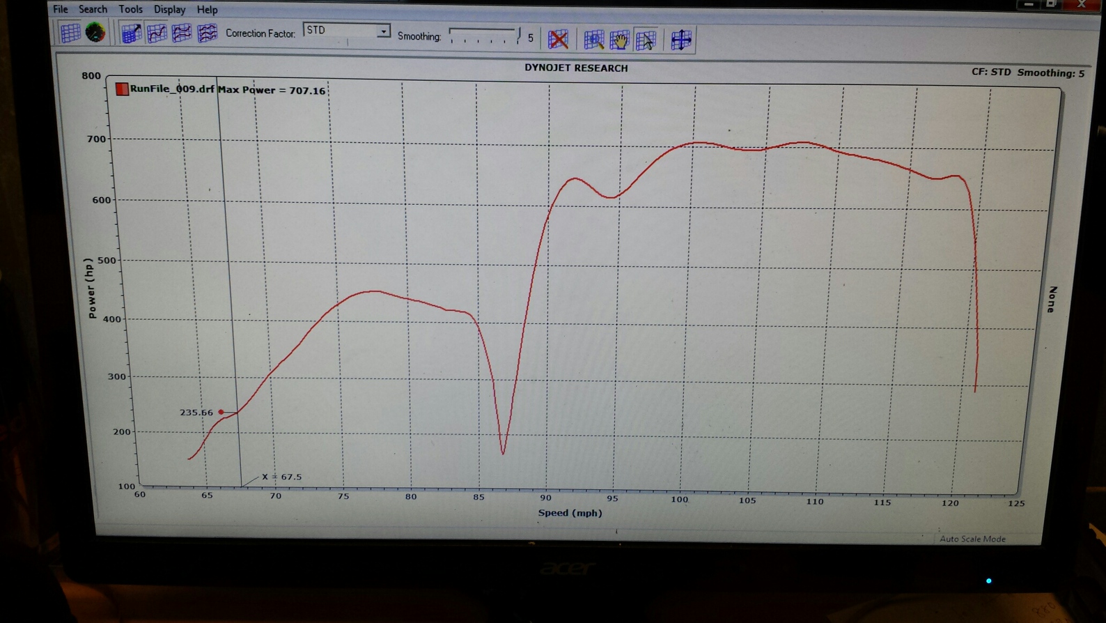

Quick run on 10lbs boost, 10* timing. Dip is due to spinning out.

dam nice numbers..what transmission/torque converter are you running?

Spec please?? Truck sounds good.

Thanks. Run on 93 pump gas only
Stock trans/converter for now,flex fuel pump, stock exhaust no cats, VVT delete, 900cc Deatschwerks injectors, Compstar Rods/Crank, Wiseco pistons -20, BTR stage 2 turbo cam, Precision 7675 CEA, 46mm wastegate, 50mm bov, etc...Fully built motor.

That a lot of engine for that turbo. Check your back pressure before cranking the boost up. Just to be sure it's not crazy high.

For sure. That turbo was spec'd by Precision for my 6.2l 800hp goal. The turbo flows really good and the boost hits quick for street. Btw it's a Trick Performance Stage 2 kit with some upgrades.

Rick turbo kits are great and if your power goal are met your good. I was thinking Ricks upgrade kit was a S480 with a 83tubine.

I bet that thing is nasty.
Byrdman- the stage 2 biggest option is 7675.
No doubt a bigger turbo would probably be a better match but this is strictly street truck and works perfect for what I'm looking for.

Sorry Sierra. I did know that info. 700hp is badass. ��
