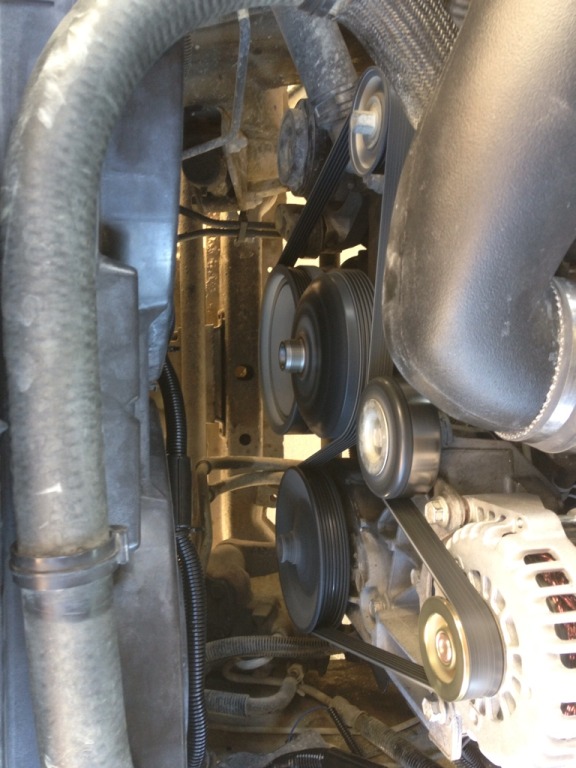

Size:  108.3 KB efans are now done too!

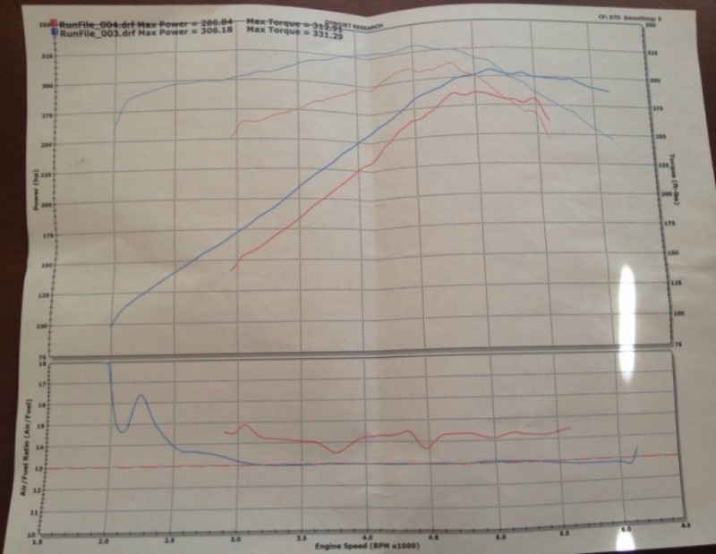

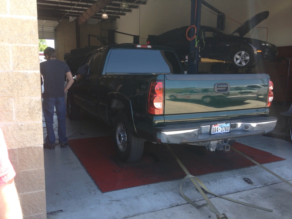

Truck on the dyno
Better picture of the graph

year and a half later..... instead of making another thread ill just post on this one, truck right now since that dyno graph has 1 3/4 american racing headers, catless connection pipes into a single 3 inch pipe into a borla xr1, efans, underdrive crank and overdrive alternator pulleys. Going to be doing a cam swap next month, parts going in: brian tooley stage 3 truck cam ( 218/224 .551/.551 133+3), pushrods, dual springs, ported ls6 oil pump, katech chain, 8.1l marine injectors (still looking for these so if you got some let me know!), tr55 plugs, 3200 single disk. Ill post the the numbers once i get it tuned just curious as to what numbers yall think i should expect.

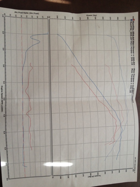

Good numbers! Hope you don't mind me turning the graph around...
