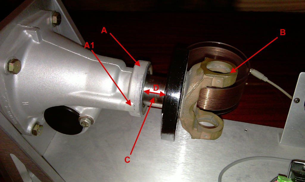

What dimensions do you need exactly? I have my half ton 4wd setup in pieces right now and.could easily measure for you

#1 the dimensions of the slip-yoke.
#2, the dimension of the outside of the transfer case output-shaft housing.
Dimensions A A1 B C & D in the pic.

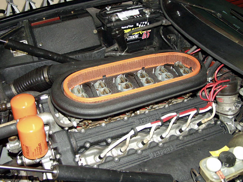

This.... is my racer
Old Dec 26, 2010 | 07:07 PM
Atomic's Avatar
I have a gauge for that
Posts: 16,282
Likes: 438
Originally Posted by dr.mike
Man that thing looks like it costs an arm and a leg to keep going, but im sure when you get on it its a lot of fun.....car looks cool too

Had to get rid of one or the other. Guess which one I kept
