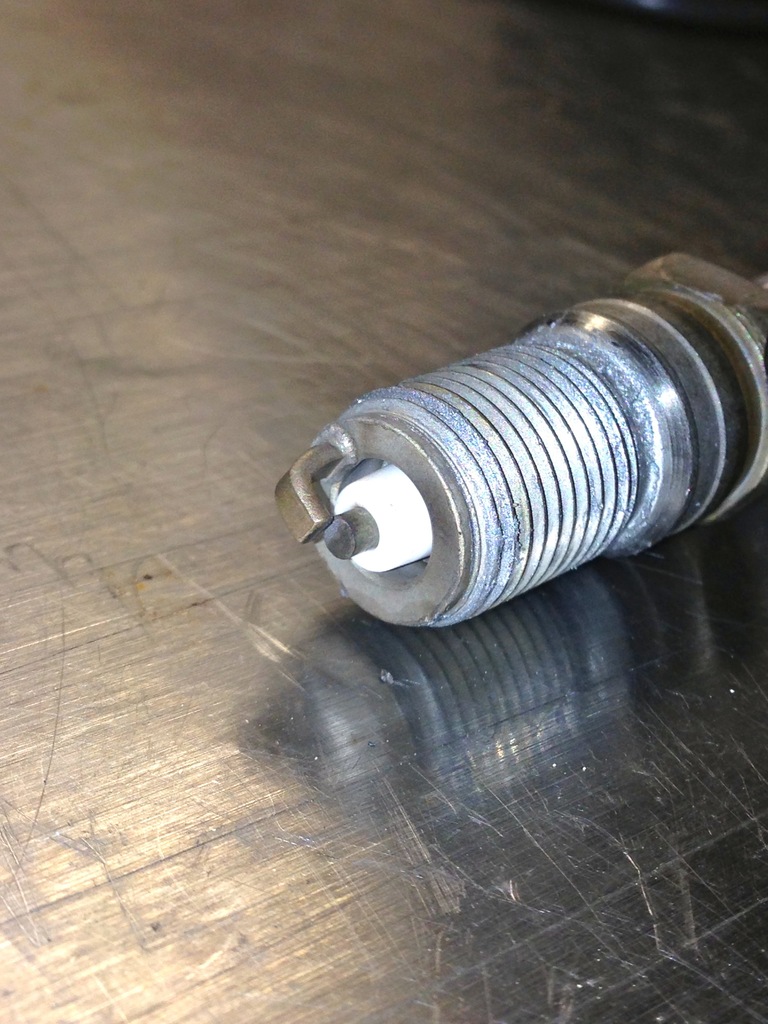

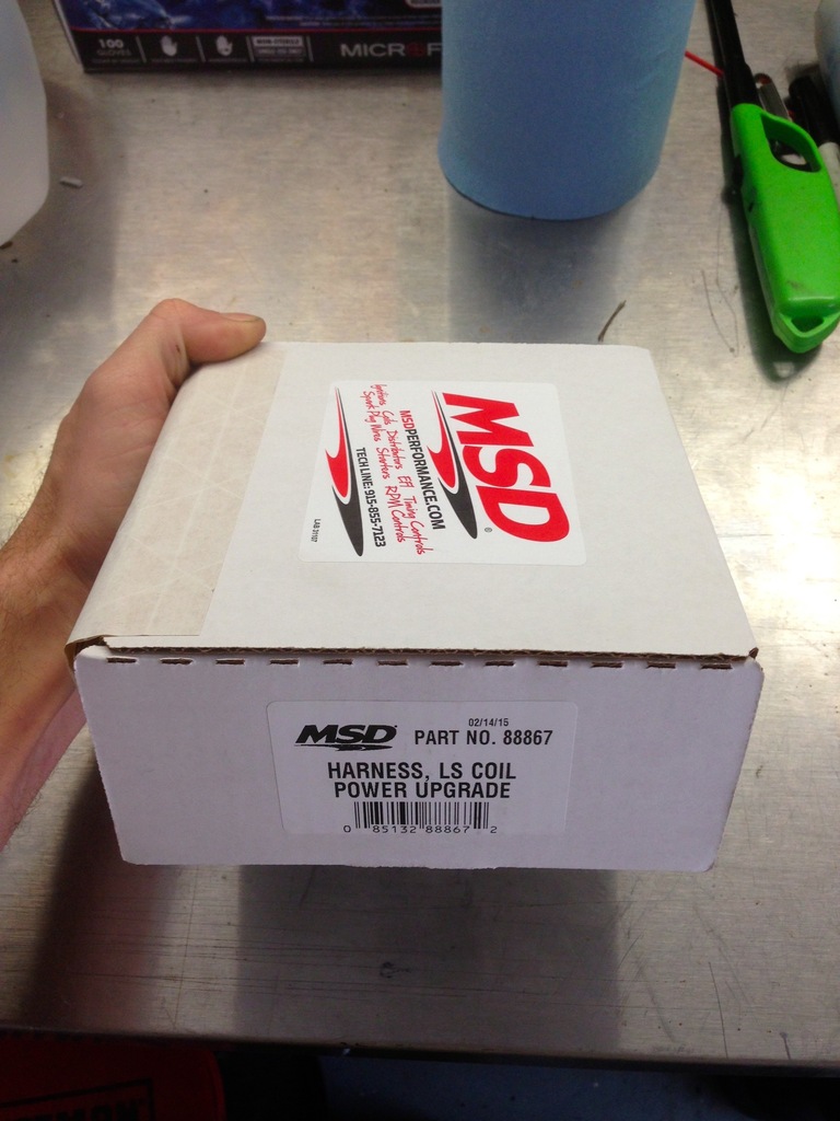

Made some progress tonight, I got the MSD upgraded power wires installed and red seems to be picking them up and layin them down pretty damn good. I also installed a couple extra grounds off the heads to ensure there wasn't somethin else going on. That said, laying into her in 3rd at mid 90 mph she was knocking the tires off tonight, so that will have to due to the dyno.
I believe the tune is pretty close under WOT on this new 3 bar setup. As you can see there is no spike in the boost on street, nice and even at 25-26psi. Added some fuel in the part throttle boost. My base fuel pressure is 60 and was holding solid at 85-86 with the recent 3-Walbro 450's and -10 feed. Looks like the 127's will tap soon, but I honestly think 25psi is my cap.
Looking forward to Saturday!

Im a little suprised you are still using a projected tip spark plug...
